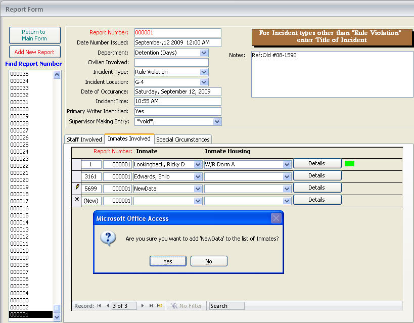

I am trying to create a command that will allow me to close out of a form without saving the data. There are multi steps to get into the forms and at two points you should be able to exit without saving but neither are working the way I want them to.

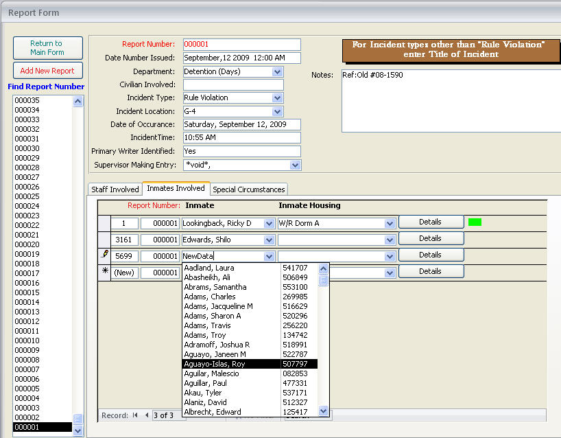

Data is entered into a field that has an item not in list event. As you type if a matching record is not found, you press enter and the first MsgBox opens. (Pic 1)

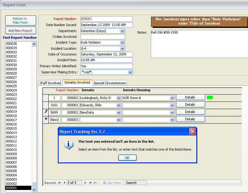

The first MsgBox ask if you want to add the New Data, (Pic 2) but when you click no instead of returning to a empty field I get a message saying The text you entered isnt an item in the list, (Pic 3) I then have to press the esc key three times (First press closes the drop-down list, second press removes entered data from the field, third press makes field undirty.

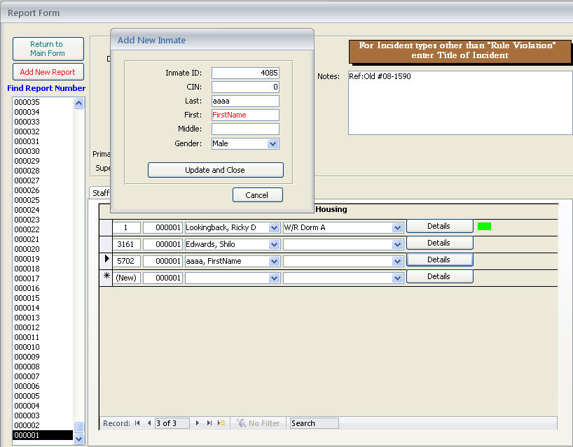

Add New Inmate form has a Cancel button in case you entered the wrong data or just change your mind. When you click the button (Pic 6) the form closes but the data is not deleted from the record. I think the problem with this button is the data has already been saved (Pic 5) base on the fact that the Inmate involved form is no longer Dirty. I am not sure if I should have code to delete the record or if I can still use an undo command.
"This is a Bound Form
"Record Source = tblInmates
"On the Add New Inmate form the InmateID field is a Auto Number Field
I have post the code I am currently using. It does not work!!!

To eliminate the "the text you entered is not an item in the list popup", in the Inmate combobox NotInList event you need to set
Response = acDataErrContinue
The Inmate combobox NotInList event will fire (if the user is in it) as soon as the uses presses the Cancel button and the focus leaves the Inmate combobox and before any code in the Cancel button dick event runs so the Inmate combobox NotInList event must handle this on its own.

The first is getting the cancel button to work for the pop-up after pressing enter when typing in NewData. I have attached a copy of the current code I am using. In the Code between the two ampersand It appears there is no instruction what to do if  it = False
I think the line (DoCmd.Close acForm, "frmEditNewInmate", acSaveYes) Should be acSaveNo

I am trying to handle this problem one issue at a time. The first is that I get a information message when I click "No" when asked if I want add the person. I have figured out how to correct that, but am still have a problem getting the comb box empty without pressing esc twice. I have explain a little better below.
I have followed the advice above and it works fine, but when I have typed in text and then click "No" when asked if I want to add the name. Changing the response to Continue suppresses the message and using SendKey Chr(vbKeyEscape) closes the dropdown, but I still have to press the esc key twice to get back to a empty form. Is there another way to clear the text entered and loose focus on the combo box?

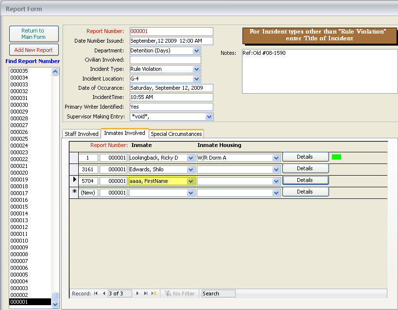

Now I have to get the cancel to work if I click yes and the frmEdfitNewInmate form opens. I want the form to clear any data in the combo box and the table and close.
        SendKeys Chr(vbKeyEscape)
        Me.InmateID = ""
   End If
   End Sub

I made the change you suggested. It works, but the combo box is still open. Maybe this is better It saves the user a step if they want to type a different name, but I have users that don't know they need to click the esc key to exit the record.
The code below open the edit form
Private Sub InmateID_Exit(Cancel As Integer)
    Dim stDocName As String
    Dim stLinkCriteria As String
    stDocName = "frmEditNewInmate"
    fncSaveRecord
    If Me.InmateID.Column(2) = 0 Then
        stLinkCriteria = "[InmateID]=" & Me![InmateID]
        DoCmd.OpenForm stDocName, , , stLinkCriteria
    Else
    End If
End Sub

You can close the dropdown of a combobox by setting the focus to another control then back to the combobox.
