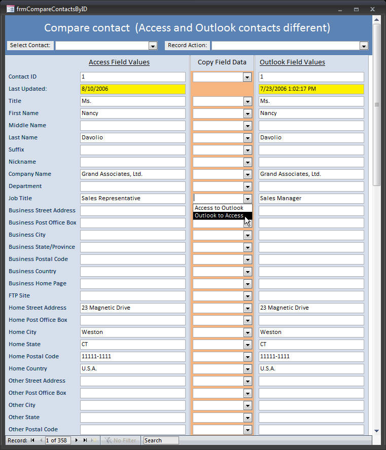

Here is a screen shot of the form (and now I remember that I switched from a checkbox to a drop-down list for selecting which type of override to do).  This form is in the sample database for my book, Access" 2007 VBA Bible For Data-Centric Microsoft Applications.
by: Helen_FeddemaPosted on 2009-10-01 at 10:26:20ID: 25470992
As you can see, this is not a trival task, but it can be done.
by: Helen_FeddemaPosted on 2009-10-01 at 10:53:39ID: 25471301
The Record Action combo box in the header offers more choices:
