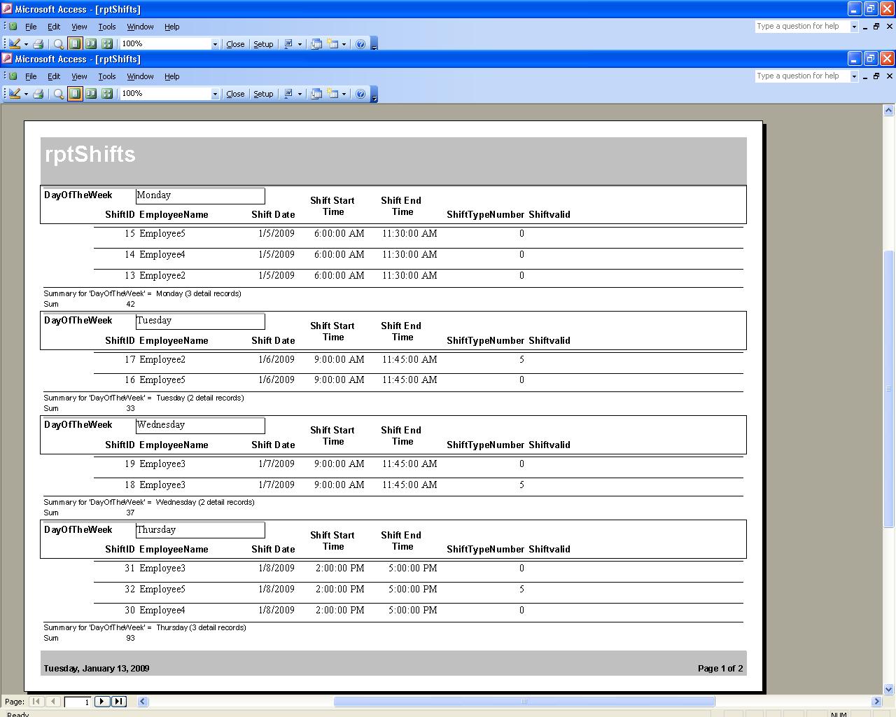

Here is a screenshot of the report "Grouped by" the day.
JeffCoachman
by: bingiePosted on 2009-01-13 at 21:50:59ID: 23370300
I'm looking for more of a calendar type view, with 8 columns (EmployeeName and the seven days) and a row for each employee.
