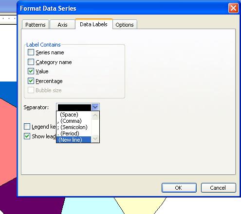

Hello, I'm trying to make a pie chart that shows currency and the percentage.  The problem I'm running into is that when I add the percentage in.  In takes away the currency formatting.  Then if I try to format it to currency, it changes the percent to currency.  Does anyone know how to fix this?

In the textbox or query use
Format (YourValueNameHere, $0.00) & " " & Format (YourValueNameHere, "%")
or to insert a carriage return between the two:
Format (YourValueNameHere, $0.00) & vbCrLf & Format (YourValueNameHere, "%")

by: bdead20Posted on 2009-08-03 at 06:17:07ID: 31610348
Sweet!  Thanks a lot!
by: boag2000Posted on 2009-08-03 at 06:39:20ID: 25004150
Can you explain how your data was structured, such that your two labels were not in the standard configuration?
JeffCoachman
by: bdead20Posted on 2009-08-03 at 06:56:59ID: 25004325
I used the attached settings on the chart properties.
by: boag2000Posted on 2009-08-03 at 08:43:40ID: 25005413
Oh, OK, So you changed the default.
Ok.
