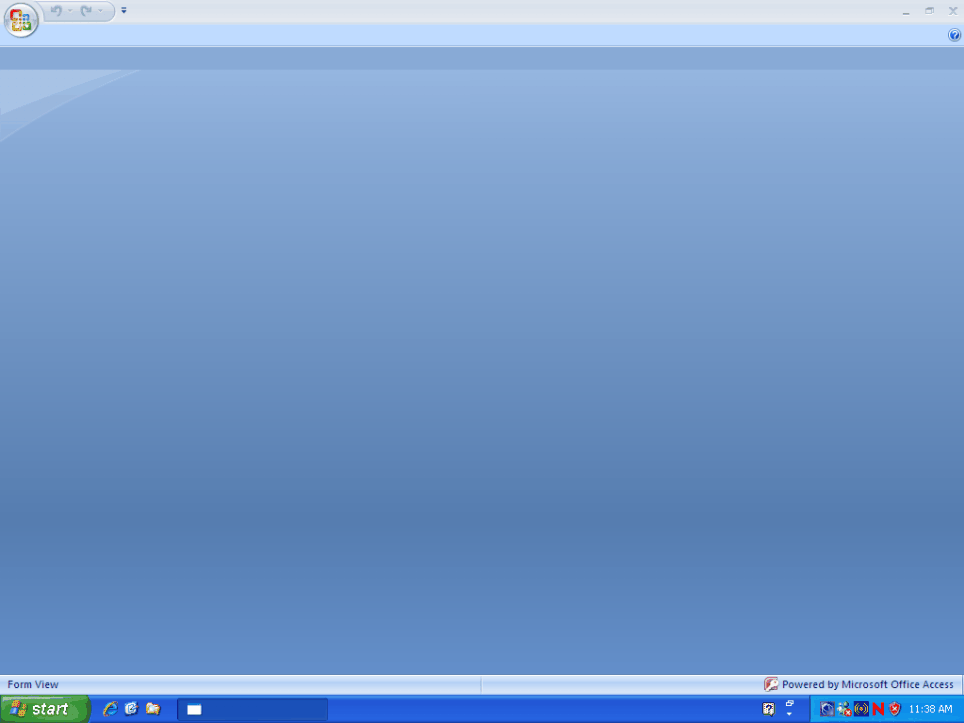

I have permission to access that folder - everything works fine on a machine that has a full version of Access 2007 installed . . . if the PC has access 2003 or no access at all, I get the runtime access screen (without the nav pane, toolbars etc) and a blank white box in taskbar, but my initial form is not there.  The only option I have is to exit.  I'll try to attach a screen capture of what I am describing.
I have read that article before, but just went through it again very carefully . . . I made sure runtime was installed on a PC without access installed - I tried the "package solution" and I also tried to simply "Make MDE" and copy the .accde dbase to the PC with runtime installed . . . same thing.
Not sure what I am missing!  It all seems pretty straight forward.
Max
    • 31 KB
    Screener of what I see when I try open the runtime dbase which should have a form on open

by: MaxwellTurnerPosted on 2009-03-10 at 14:21:06ID: 23851558
Okay I officially deserve the DumbAss of the year award! Lol!  Sorry for wasting your guys time!
I use dual monitors and was running access on my secondary monitor.  Turns out the form was opening, it was just off the screen way to the left side.  Figured this out when I tried it in our conference room with a big flat screen and then I could just see the corner of the form off to the left.
Did it all again using my primary monitor and voila . . . it all worked as it should.
I feel quite foolish, but live and learn I guess!
