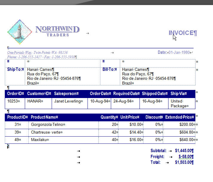

by: Helen_FeddemaPosted on 2009-08-06 at 15:36:52ID: 25038760
Here is a code sample that exports linked data to a Word document (an invoice with main invoice info in the top, and a table listing invoice details below.  The code is listed below; it uses a Word template

by: Helen_FeddemaPosted on 2009-08-06 at 15:38:11ID: 25038769
For two sample databases (one in Access 2002-2003 format, the other in Access 2007 format) plus a set of Word templates, see my new ebook, Working with Word(http://shop.office-watch.com/aww/), which describes many ways to export Access data to Word documents.
by: Helen_FeddemaPosted on 2009-08-06 at 15:39:41ID: 25038777
The technique for the invoice is to write the main invoice data to doc properties in the Word document made from a template, and use TypeText to write the linked invoice detail data to rows in a table, as many as are needed for each invoice.
by: Helen_FeddemaPosted on 2009-08-06 at 15:43:18ID: 25038801
Here is a screen shot of the resulting Word document:
