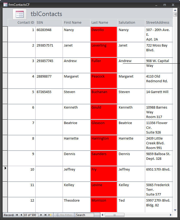

The short answer is "Yes, you can, but it won't work as you intend"  Here is a trival procedure to colorize a textbox if a condition is met:
Private Sub Form_Current()
   If Me![ContactID] > 9 Then
      Me![txtLastName].BackColor = vbRed
   Else
      Me![txtLastName].BackColor = vbWhite
   End If
End Sub
by: Helen_FeddemaPosted on 2009-08-15 at 12:25:31ID: 25106567
On a continuous form, it makes txtLastName Red for all rows when you are on a qualifying row.  On this tyjpe of form, anything that is not determined by binding to a field in the record is the same on all rows.  There are some ways of getting around this using Conditional Formatting, but it only permits 3 conditions.  Here is a screen shot illustrating the above problem:
