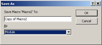

BTW, you can right-click a Macro in the database window and have it converted to VBA.
