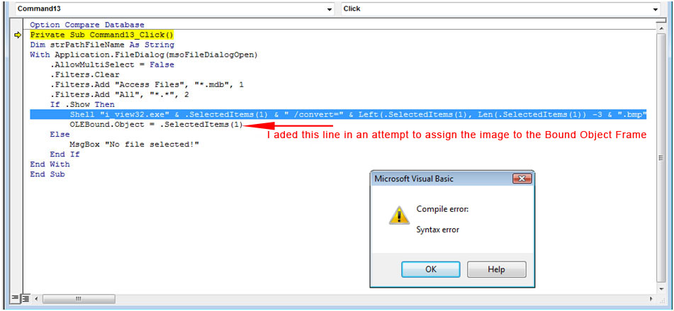

When I place this code into the click handler for the button it is getting a compile error: "Expected list separator or )" on the shell command
As well: Where in the code would we link the picture being saved into the bound object frame called OLEBound?
Thank you for your patience.
by: studentdataPosted on 2009-09-11 at 12:18:25ID: 25312619
Here is a screen shot of the error, I don't know if this will help...
