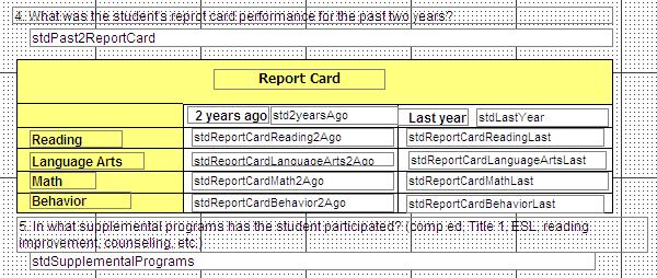

I have several expandable fields on my report. I would like to place several of these expandable fields into a table (read grid) within my report. When the fields expand, so to will the table or grid. Thus far I created a grid using boxes and lines to make my column and rows and place my fields in the cells. Of course when my field expands the content within the field bleeds over the cell lines.
Any help you can provide would be great!  Working on a project with a deadline...

Folks,
Thanks for the quick response. Attached is screen shot. After looking at the screenshot, are you suggesting that I would need to create 15 separate textboxes to accomdate each "can grow" text field? Given the layout, if the last year columns had a great deal of data would the adjacent "2 years ago" column span as well? (this would be fine BTW).
This is all on a report so not certain if I want to deal with several subreports. And landscape is out of the question because the form must be portrait orientation.
Thoughts?
Thanks again in advance for looking at this.

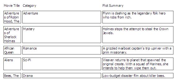

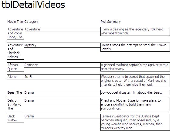

OK:
"expandable fields"=Textboxes with the Can Grow property set to yes.
The Textbox/border technique works well if  all the boxes will "Grow" to the same Height, else they will end up "Staggerd" see screenshot 1.
In Access 2007 this is remedied by using grouped controls in a "Layout " see screenshot 2
There are several techniques to do what you are asking directly though, here is a popular one:
http://support.microsoft.com/kb/170838
