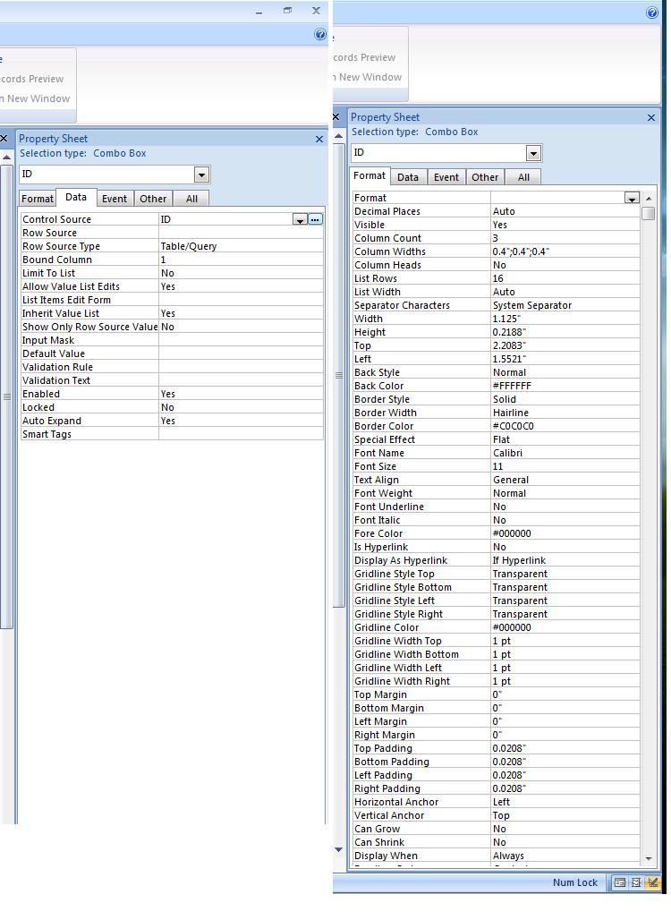

I can't upload the file but here are screen shots of the settings. I have to dynamically set the rowsource. That part of the combo box works with out issue.

Access always selects the first column of the query to display and store. If you use select id, prefix, postfix from emp; instead, then it will display and store id once you select it. All three choices will still display when the menu is dropped down.
