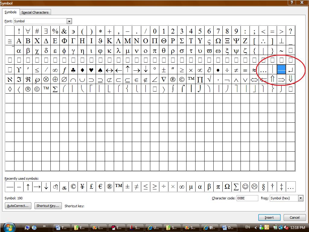

Hi I am currently writting a regular expression in VB.NET in VSTO. I can detect any punctuation except the one attached in my screenshot. It seem to be a symbol (hex)??? What is it? How do I detect this by unicode???

The symbol is not a em dash. From I gathered it seem to be a unicode of "F0BE" which I cannot seem to be able to detect in word 2007.

Orh? So does that mean I cannot detect this in word 2007? If u refer to my screenshot, it seem to be a Symbol font unicode stuff,,, What does it mean...?

Well, when you are actually in Word you can find this symbol character via VBA code by finding the text defined as ChrW(61630).  So in Word VBA you would do something like:
Selection.Range.FInd.Execute(ChrW(61630))
which return True or Flase depending on whether the symbol character is found
In VSTO, you could try using the Word application object (e.g. if defined as objWordApp) and try
objWordApp.ActiveDocument.ActiveWindow.Selection.Range.Find.Execute(ChrW(61630))
Now when I tried it, I get False even though the symbol is in my document, so this is not likely an option for you (unless I missed something).

Okay, well you could try the following to see if the character is found (a message box will pop up with the result).  Again, the code example uses the Word application object (e.g. defined as objWordApp)
Dim objWordApp As Word.Application
objWordApp = WordAddIn1.Globals.ThisAddIn.Application
With objWordApp.ActiveDocument.ActiveWindow.Selection.Find
    .ClearFormatting()
    .Text = ChrW(61630)
    .Replacement.Text = ""
    .Forward = True
    .Wrap = Word.WdFindWrap.wdFindContinue 'or .Wrap = 1
    .Format = False
    .MatchCase = False
    .MatchWholeWord = False
    .MatchByte = False
    .MatchWildcards = False
    .MatchSoundsLike = False
    .MatchAllWordForms = False
    MsgBox(.Execute)
End With
by: irudykPosted on 2009-09-02 at 05:23:10ID: 25240180
Just curious if you had success with the above code? Using it, I was able to locate the symbol.  Seems strange though that I had to write the code the way I did in order to find the symbol as opposed to executing the find in one line of code which as we found out did not work.
