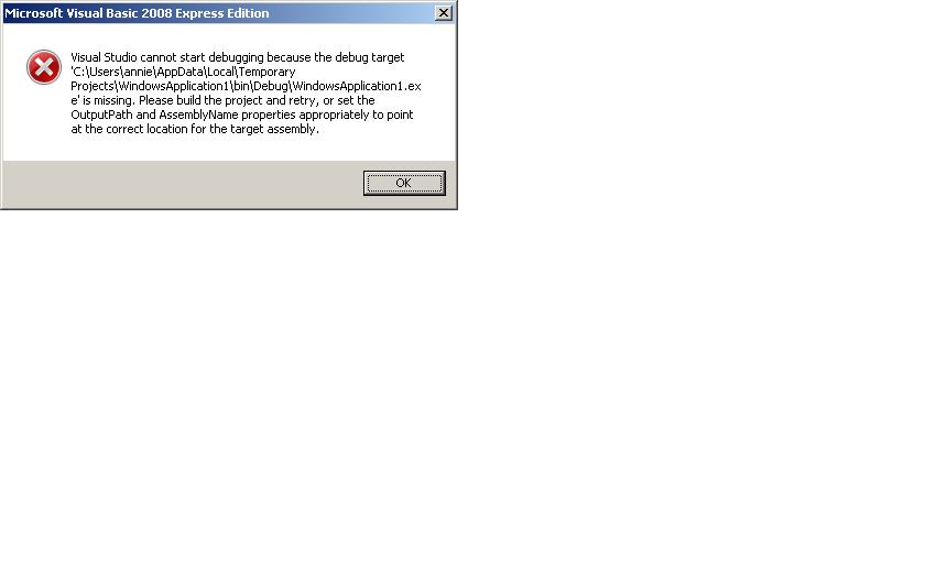

I try to test run code in Visual Basic 2008 Express edition an I receive an error message
Asked by: itbabe
See attachement  below

by: itbabePosted on 2009-09-05 at 01:48:11ID: 25265386

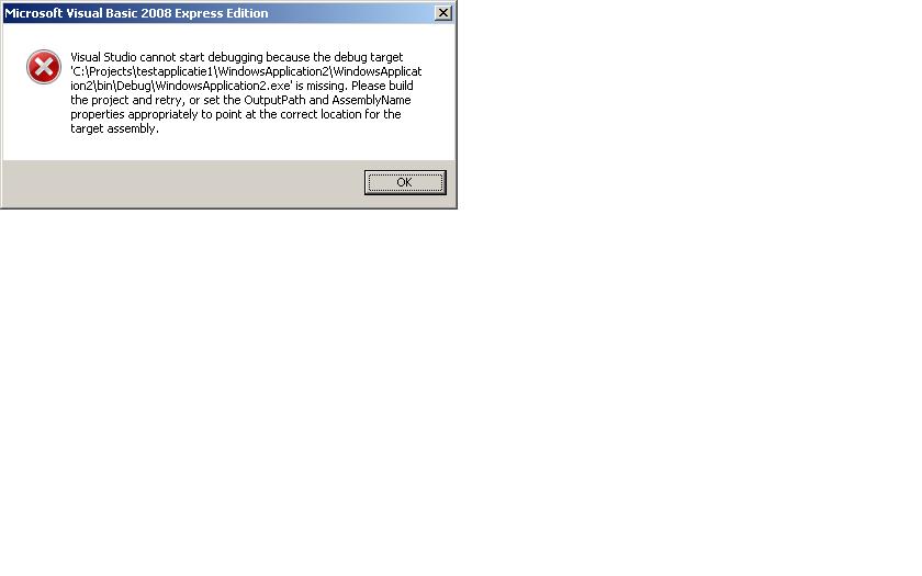

I have create a project from another location but then I receive the following error message.
by: itbabePosted on 2009-09-05 at 01:48:49ID: 25265387
Seems I didnt attach the file.
by: NeilsrPosted on 2009-09-05 at 01:57:18ID: 25265398
Have you done a full build of the project before you try to step through it?
by: itbabePosted on 2009-09-05 at 09:18:41ID: 25266737
There were aparently errors in the code that inhibited me from building the project.
