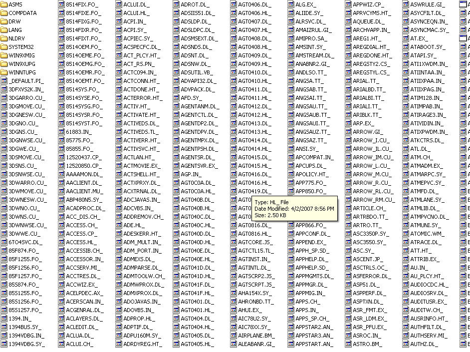

by: ChristopherDunnPosted on 2009-03-24 at 18:06:36ID: 23975146
There is thousands of files, but here is a snapshot of what is in the i386 folder of my XP pro SP3 CD. Image attached.
by: dll32Posted on 2009-03-24 at 18:22:52ID: 23975233
Looks like my Disc #1

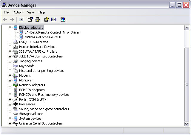

I'm sorry to hear that the other actions didn't fix your problem. Rest assured that they still will benefit your computer's stability in the future. If you've started to recreate the profile, then go ahead and finish that first. Otherwise, I think we should try an updated graphics driver first.
Do you know what brand of graphic card you have?  You can find out by right clicking on My Computer and selecting Properties. Select the Hardware tab and click on the Device Manager button. Doubleclick on Display Adapters to open it and show your adapter(s). Let me know what you have there and we'll find you the right driver. I've attached a screenshot of what I'm looking for.
Something else you can look at:
http://www.experts-exchange.com/OS/Microsoft_Operating_Systems/Windows/XP/Q_20778140.html?qid=20778140 suggests that the problem may be a dll file call xplugin.dll. If you see this file here: Windows>system32>xplugin.dll, then try to delete it. I really don't think that will be it though.
by: dll32Posted on 2009-03-26 at 01:26:20ID: 23988172
Have not recreated profile
I have NVIDIA GeForce 6150 LE

by: ChristopherDunnPosted on 2009-03-26 at 10:30:26ID: 23992960
This is your driver: http://us.download.nvidia.com/Windows/182.08/182.08_geforce_winxp_32bit_english_whql.exe
Disable your antivirus while it is installing, if possible.
by: dll32Posted on 2009-03-26 at 12:34:23ID: 23994264

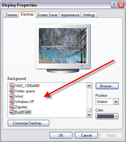

After 4 minutes, [Desktop] tab OPENED!  But, the only background options are some of my own pictures!?
by: ChristopherDunnPosted on 2009-03-26 at 13:01:37ID: 23994563
"After 4 minutes, [Desktop] tab OPENED!  But, the only background options are some of my own pictures!?"
Was this before or after installing the driver, or recreating the profile... and when you say after 4 minutes, does that mean it took 4 minutes to open?
by: dll32Posted on 2009-03-26 at 13:05:38ID: 23994616
I have not recreated the profile
yes, 4 minutes to open the tab
I assume it took so long to open because of the large amount of pictures???

by: dll32Posted on 2009-03-26 at 15:38:43ID: 23996421
"It" does
I have way over 150 pics in MyPictures
I rebooted after the driver install
When I hit [Browse] in [Desktop] Background, it opens up in Internet Explorer Folder with 2 files of type: Background Files - [1] Quick Launch folder and [2]Internet Explorer Wallpaper, 1902KB BMP file.  When I click on Quick Launch folder, nothing. When I click on IE Wallpaper nothing.
I looked at my laptop and the display properties>desktop>background browse opens in C:\Windows\Web\Wallpaper.  I found the file in the Browse button, but when I open the Wallpaper folder, I see all the images provided by microsoft, but can't click shift to select all and open.  I can select each item individually.  *&^%$#@
by: dll32Posted on 2009-03-26 at 15:48:37ID: 23996489
Sorry, all the Web Wallpapers are there - in alpha order with my pictures.  I have to figure out how to get those pics out.

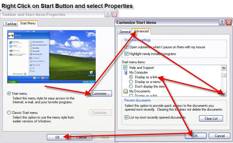

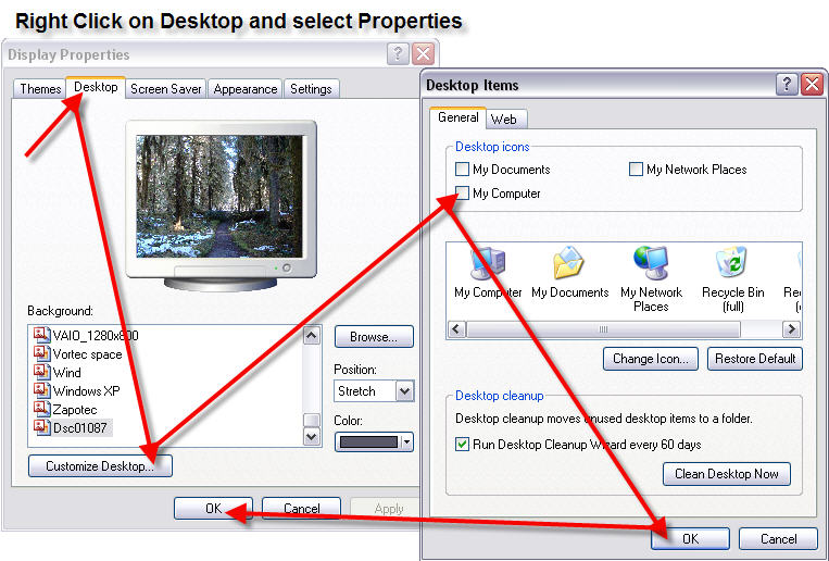

BTW,  My Computer folder does not appear on my Start Menu.  In Customize Start Menu>Advanced>My Computer the Display as a link is checked.  My desktop shows Shortcut to My Computer, I click to open and in the Address box I scroll down to click on which drive I want to open.  Know how to put My Computer folder back on the Start Menu and My Desktop?

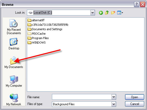

by: ChristopherDunnPosted on 2009-03-26 at 15:50:48ID: 23996510
I'm not sure I follow, but the browse button will take you to the folder where you last successfully picked a wallpaper, so just click where I've indicated on the screenshot to select my documents, and then you can pick My Pictures from there and pick your wallpaper. You can only select one wallpaper at a time.
How many items are in your desktop wallpaper selection area?
What step takes 4 minutes? Selecting the desktop tab? clicking browse?
by: dll32Posted on 2009-03-26 at 16:08:49ID: 23996634
With all due respect, did you read both my posts?
It takes 4+ minutes when I SELECT the desktop tab.
"How many items are in your desktop wallpaper selection area?"
Do you mean, when I click on browse while in the desktop background area?
If so, it opens up in Browse, Look in:  My Pictures, all 21.8 GB of them.
I assume you meant for me to open My Documents in Browse, and when I do, it opens up in My Documents, all 46.4 GB of them.
Your  .jpg of the Browse has My Computer on the far left column -- I don't have that there.

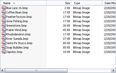

by: ChristopherDunnPosted on 2009-03-26 at 21:39:49ID: 23998097
After reading dozens, if not hundreds of posts (two of which were on EE), only one of them reported any success in treating this problem. I do have a couple suggestions.
1. Go to http://update.microsoft.com and ensure your computer is fully updated.
2. Run a search in your My Pictures Folder for any of the files in the attached picture. If you see any of them, either delete them or rename them to something else. This is from post #51 on http://www.techspot.com/vb/topic100105-3.html
If neither of the above two works, I'm afraid you'll either have to live with it or you'll have to move your pictures to a different folder. There are many posts that indicate this is the default behavior of Windows XP, but it does not do it on my machine (after 100 or so pictures), so it may be a Media Center bug.
If you need help in moving your pictures, let me know. You can also trick your system into looking in a different location, but that may affect other programs and I don't really recommend it. You may be able to change your default wallpaper directory and that may get rid of all the other entries. Let me know if the above two options don't work.
by: dll32Posted on 2009-03-26 at 21:45:32ID: 23998115
OK, I'll do both and get back to you.  I recognize Zapotec.bmp right away. Thank you!
by: ChristopherDunnPosted on 2009-03-26 at 21:53:56ID: 23998134
Note that these are default wallpapers. Don't delete them from C:\Windows (unless you want to remove them from your system completely). Only delete them if they are in your "My Pictures" folder.

I read the #51 post you referenced, and I think I might have more than one picture file, so hang on . . .
by: dll32Posted on 2009-03-27 at 14:49:04ID: 24005788
I have the same 11 BMP Default Wallpaper files as you attached in ID:23998097, PLUS the following:
Picture It! Wallpaper  4,219 KB BMP  6/17/2008
Roxio PhotoSuite Wallpaper  1,899 KB BMP  9/20/2008
Roxio Wallpaper  1,899 KB BMP  9/20/2008
Might these be part of the problem?
I could fing no other BMP files in my picture folders
by: dll32Posted on 2009-03-27 at 16:40:10ID: 24006409
I meant "find" BMP files.  Should I delete the above 3 files?  If this doesn't help, should I still try to create a new profile and copy over files?  Could you please tell me how I can get My Computer to appear back on my screen and my Start Menu?
by: ChristopherDunnPosted on 2009-03-28 at 17:49:20ID: 24010935
Hey there. Sorry it took so long to get back to you. I was writing a script to fix this for you.  I've attached the script. Delete the ".txt" extension and run it. Read the intro and select option 1. Option 2 just puts everything back the way it started, in case you don't like the change. This script will create a folder called "Default" in your My Pictures folder. The display tab will only list files in that folder. Because this is a workaround and not a fix, any program that is looking for "My Pictures" may default to the "Default" folder, but this shouldn't cause a problem. It will also make this change for all future users, but not any other ones already created (if you want that, you'll have to run this from each user). The code is below in case anyone reading wants to know.
To answer your other question, just follow the images I've posted.

by: ChristopherDunnPosted on 2009-03-28 at 17:53:28ID: 24010942
To download the script, Right click on the link and "Save link as..." and for the filename put this in:
"Background-List-Workaround.bat"
Make sure to include the quotes. This will remove the .txt extension. (EE won't let me upload executable files).

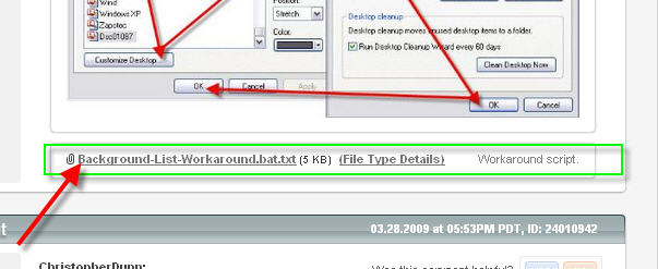

One question before I begin, and I apologize in advance for not finding it, but where is  the "link" you refer to here:
"To download the script, Right click on the link and "Save link as..." and for the filename put this in: "Background-List-Workaround.bat" Make sure to include the quotes. This will remove the .txt extension. (EE won't let me upload executable files).
Thanks.
by: ChristopherDunnPosted on 2009-03-29 at 19:26:41ID: 24015669
hmmmm.... I'll have to check into that My computer thing.
The link is at the very end of post  24010935. See the green box in my attachment.
by: ChristopherDunnPosted on 2009-03-29 at 19:55:43ID: 24015733
It is likely that the My Computer option was disabled by malware. You can re-enable it by right-clicking on this link and choosing save target as... (or save link as...) and saving it to your desktop. http://www.lprf.ca/files/cntrlpnl/dsplyprprts/MyCmptrDsktpIcn.Allow.reg
Once it is on your desktop, double click on it and click yes to merge the file, then reboot the computer. This should re-enable the option and allow you to change it like in the diagrams.
The malware that did this was most likely already removed from your system when you ran malwarebytes earlier (now you are just cleaning up some of its tracks).

I downloaded the script, saved it as instructed, chose Option 1.  Opened display properties/desktop and still the "pictures" are still there.  I rebooted the system and the same results occur.  I couldn't find the file in My Pictures (sorted everyway possible), so I did a search and it appeared right away in:  C:\Documents and Settings\HP_Administrator\Desktop\My Pictures.  I looked again and it wasn't there.  I copied the Default folder from the search file to my desktop and then put it into My Pictures file.
The My Computer icon issue was successfully corrected as you instructed! Thanks!
