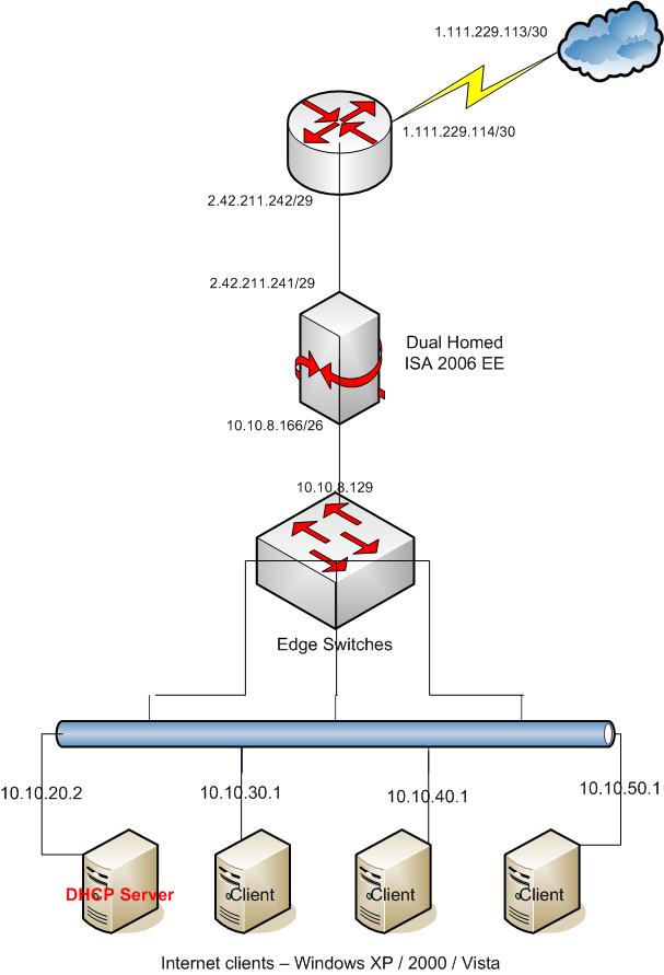

Having installed ISA 2006 and patched it with SP1, there was a need to use it as web proxy/cache solution. The Internal networks were defined as 10.100.8.*;10.100.9.* etc during installation.
The dual homes ISA server has a public ip of (2.42.211.241) on the outside interface on which I intend to NAT outgoing traffic.
The two interfaces of the cisco router 1800 series are already on public IPs.
What do I do now??
Configure Ips on the router interfaces and then
define dynamic routing by using rip and define two networks ( 1.111.229.0 & 2.42.211.0) ? or use static route commands?
Second, on ISA , I create a rule: Allow > HTTP/HTTPS > Internal > External > All users ( I don't want to authenticate yet, though I'll enable LDAP later)
Then what?
Consider me a novice pls...and guide step wise...
Thanks in advance!!

Hi Fahim, If you setup ISA as an edge firewall, that will get you most of the way there. ISA Server -> Configuration -> Networks -> Templates -> Edge Firewall
Follow the wizard entering your internal address range (i.e. 10.10.x.x) and choose a basic rule set to get you started.
If you then go to ISA Server -> Configuration -> Networks -> Network Rules Tab, you should see an Internet Access rule that relates your internal network to external with a NAT relationship.
Not sure about the setup of the Cisco as that's not my area of expertise, but I would have thought a static route between 1.111.229.0 & 2.42.211.0 would do the job.

Eric, would implement this in about an hour and send an update, I was wondering though, wuld my clients that would technically be called as SecureNet clients, talk to my ISA is I push the IP of 10.10.8.166 within IEs LAN proxy server settings via my Group Policy?
I cannot make all my Internet bound traffic pass through the ISA just yet!!

Thanks for clarification Eric. Problem is, I cannot set 10.10.8.166, as a DG for my clients spread across 10.10.*.* subnets.
As of now, I only need to take the web traffic of 10.10.20.* and 10.10.30.* subnets, outside via this ISA. For all my subnets including these, their DG points to another campus LAN core switch where all my application servers reside...and there is a filrewall too for internet connectivity. The reason for bringing in this ISA to take off some of the internet bound traffic off that other link.
So, I guess, my option is to only use my clients as 'Web proxy Clients' and can use authentication with my 2003 AD by enabling LDAP. If my domain name is ab.company.local, what would be my LDAP context to be filled in?
I don't want to make this ISA as part of domain, for soon, I need to shift this to a DMZ area for publishing my OWA, once this thing starts working.
