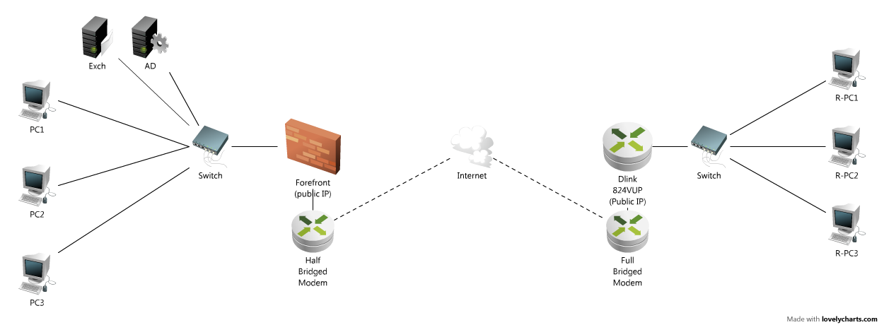

Argh, i knew i would fail to explain correctly. I have attached a speedily crafted network diagram from an online diagram thingy, don't have visio loaded.
As you can see, i should have explained better!
On One end, forefront has a public IP address via a half-bridged modem. On the other end(2 remote offices), are Dlink modems connected via full bridged modems. Each Dlink, and Forefront has a Public IP.

by: pwindellPosted on 2009-09-22 at 06:03:58ID: 25392295
Thanks for the clarification. And I think you did a fine job of explaining that.  I'd like to know what the online drawing program was :-)
