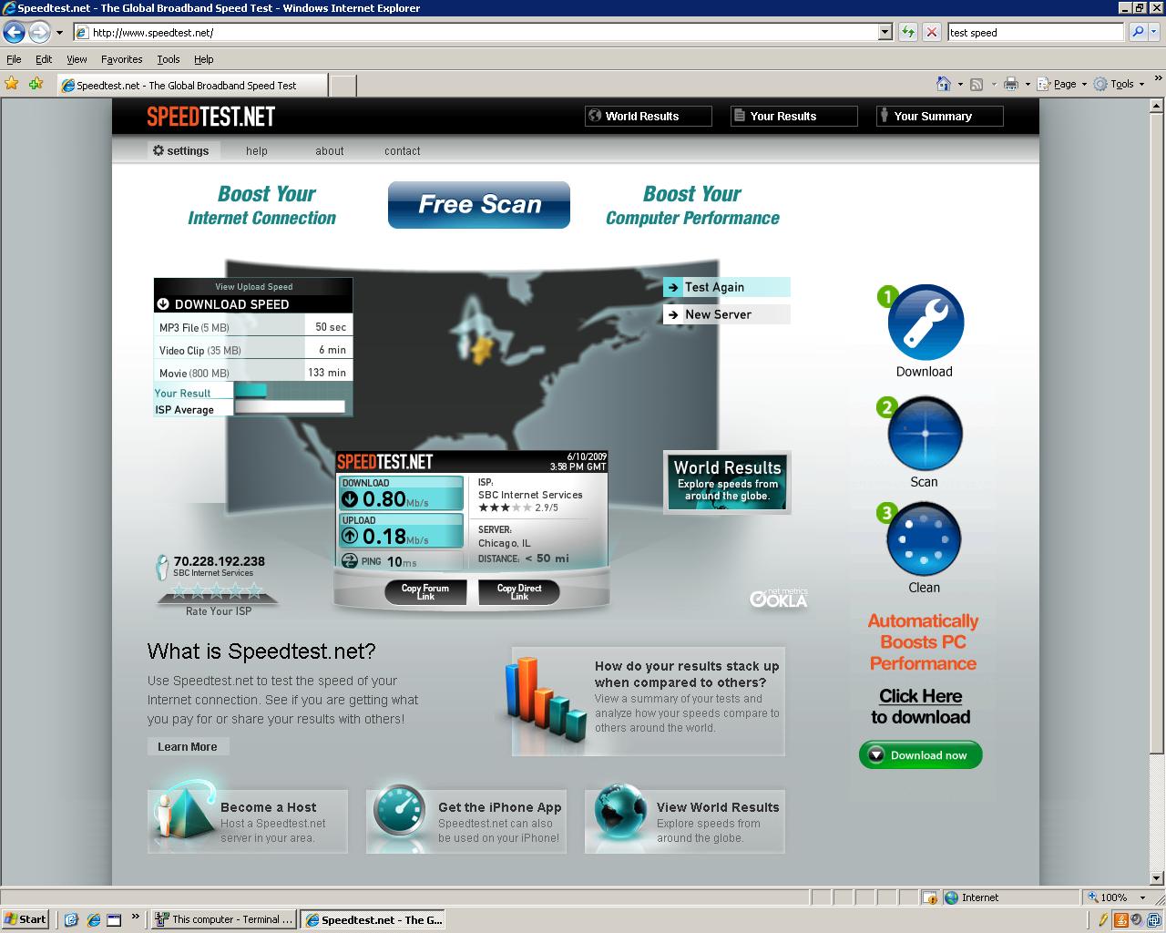

Update - I just did a speed test from our terminal server. (I rdp'd to it from inside the network..)
The servers are connected via switch (cisco 3560) to a cisco router breaking up a T1)
    • 165 KB
    sucky connection
    sucky connection
by: jmarti80Posted on 2009-06-10 at 09:27:41ID: 24593455
The screen shot above tells you all you need to know.  It looks like it's a simple bandwidth issue.  VPN alone takes up extra bandwidth because it is encrypting everything that passes through the network, coupled with the use of terminal services, I don't think your DSL line can handle it.  Your statement that everything from the inside seems to work fine further supports this.
I would verify this by connecting directly to the Modem (configure your laptop with the static IP's and GW provided to you by the ISP) and then running the same speed test.  This will tell you the true bandwidth that your ISP provides, if it is significantly higher, then that basically suggests that your users are using the bandwidth and you definetly need to increase it.  If it is the same as the screen shot above, then the problem is on the ISP side for sure.
My suggestion would be to simply increase the Bandwidth provided to you by your ISP (provided that the above is done).  I wouldn't add anymore lines, I would just contact your ISP and see if they can increase your bandwidth on that line.  If not, then you may have to go with a T1 or higher with increase pipes.
Good luck.

One more thing... That Speed test that you did was it done from the satellite office or from the corporate office. I know you did it from Terminal Services, but where did you do it from?
by: jamie177Posted on 2009-06-10 at 13:21:01ID: 24595927
cisco 2620xm is the router that we have at the satellite office I believe.
VPN is from the router or our PIX515e. I can't remember at the moment.
The speed test was from me rdp'd to the terminal server from my computer inside the corporate office. It was on the Terminal server's browser. I did one from my computer and got a similar speed.
