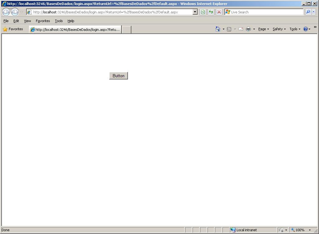

by: naspsPosted on 2009-03-26 at 08:33:46ID: 23991550
Just did what you've told (change index.aspx to Default.aspx, right-clicked and set it to Set as Start Page)
but it keeps giving me a bad URL (he's looking for login.aspx - see attach). I'm doing it locally.
I'm afraid that all those web.config changes we've made to get the page going, actually "blown" something.
by: jjamstrongPosted on 2009-03-26 at 09:25:53ID: 23992196
The space in /BasesDe Dados/login.aspx is what giving you the error. A Web project has to be created without spaces in the name. Recreated as BasesDeDatos
by: naspsPosted on 2009-03-26 at 09:36:20ID: 23992320
Worth the try but still the same error...

by: jjamstrongPosted on 2009-03-26 at 10:04:48ID: 23992692
do not exclude the login.aspx page... it will always look for the login page... because you started with membership and roles, so in your web.config file have the configuration to look for it. Include the Login.aspx file into your project so it can work.
by: naspsPosted on 2009-03-26 at 10:14:06ID: 23992795
Ok,I've included once again the login.aspx in the project. Seted again Default.aspx as start page, hit F5 and the browser shows login.aspx. Weird thing is the URL. It appears that is set to redirect to Default.aspx but first...login.aspx (see attach). The button was a trial for me to pass this page by doing response.redirect("Default.aspx") but no luck...
Is it time now to start all over? :)
by: jjamstrongPosted on 2009-03-26 at 10:54:24ID: 23993225
You don't have to start over. I think I know what you did!!! You configured that the main site canot be accessed unless it's and autentecated user. If it is so do the following steps!
1. In the ASP.NET Configuration (whitch is in the Website menu - ASP.NET Configuration) click on the security Tab.
2. Click on Manage Access Rules
3. In the window that apper remove any rule created on your main application directory (whitch would be BasesDeDatos folder).
4. Click on the Done button (bottom right corner of the browser)
If this isn't the poblem well you may have to start over.
