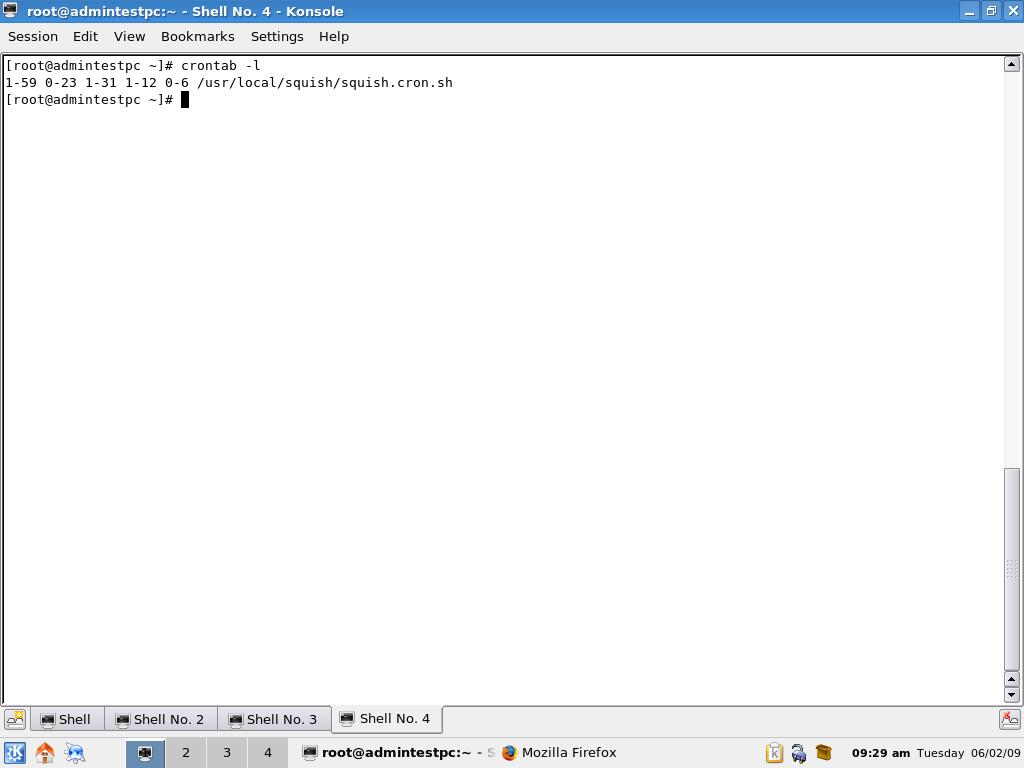

by: rajasekarramasamyPosted on 2009-05-28 at 21:59:55ID: 24500200
can you post the output of crontab -l as user root?
output:
no crontab for root
I have attached my crontab file pls check the attachment.
Squish quota reset is working for you?
Is there any free proxy server having quota management?
by: ai_ja_naiPosted on 2009-05-29 at 05:52:13ID: 24502346
try putting squish quota reset script into a root crontab, so that we make sure it resets things

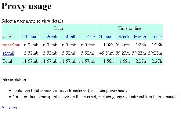

by: rajasekarramasamyPosted on 2009-06-01 at 21:08:14ID: 24523831
Hi ai_ja_nai,
I have added squish-cron in root crontab please see the attached root crontab screen shot.
Squish quota not resetting by next day. please see attached  squish screen shot. I have checked my squish quota by next day @9.30 AM squish has not reset quota. Everything thing is working fine except quota resetting.
by: ai_ja_naiPosted on 2009-06-02 at 10:51:22ID: 24529498
And after how much time did it reset?
by: rajasekarramasamyPosted on 2009-06-03 at 05:20:19ID: 24535549
