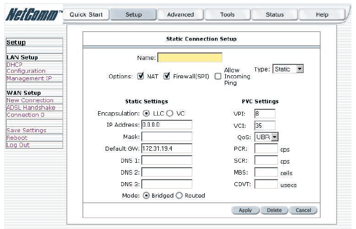

For now, I've had to connect the modem/router (NB5) into one of the LAN ports of the WRT610N. This setup works as long as the clients have static IPs - since the WRT's DHCP is telling clients to use itself as the Def Gateway instead of the NB5. What I would prefer to do is plug the NB5 into the WRT's Internet (WAN) port, to free up a LAN port for other use. However, when I do this, while client PC's can PING the NB5 via the WRT, neither the WRT or clients can ping www.google.com - address resolution (DNS) fails. The NB5's WAN IP is dynamic due to our ADSL provider's setup (iPrimus Australia)

I assume there should be some way to get all this working by plugging the NB5 into the WRT's Internet port instead. Here's what I've tried:
Change NB5 LAN IP address to put it on a separate network as you do with multiple routers:
IP - 192.168.0.1/24
Change WRT Internet IP to static - 192.168.0.2
Note that I've also tried setting the WRT Internet IP to auto - and the NB5 DHCP gives it the same x.x.0.2 address.
In both cases the WRT and client PCs can't access the Internet - despite both being able to ping and tracert the NB5.
