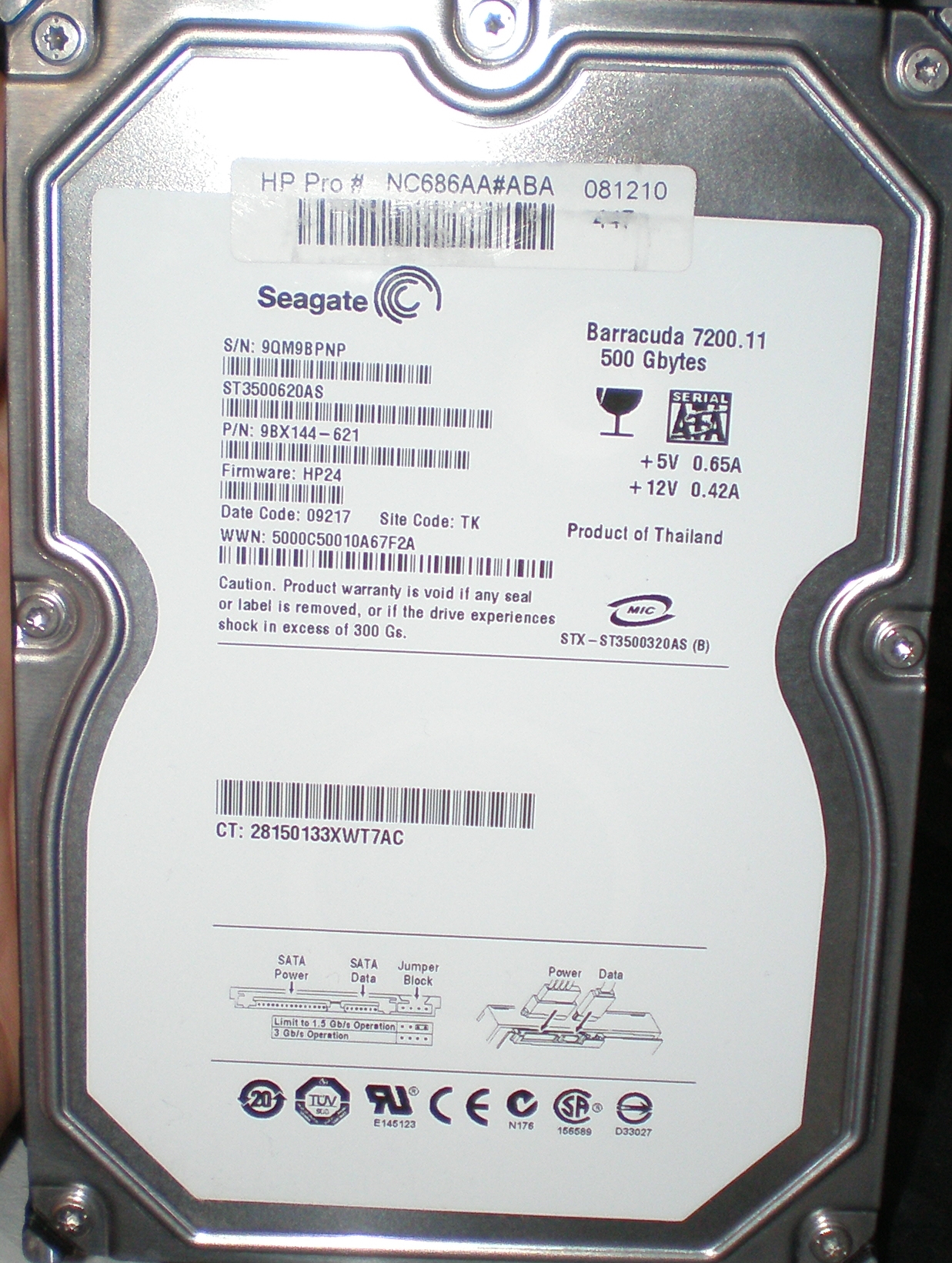

Attempting a data recovery on a Seagate ST3500620as  500 gb sata drive. P/N 9bx144-621
Firmware HP24   Date Code  09217  Site Code TK

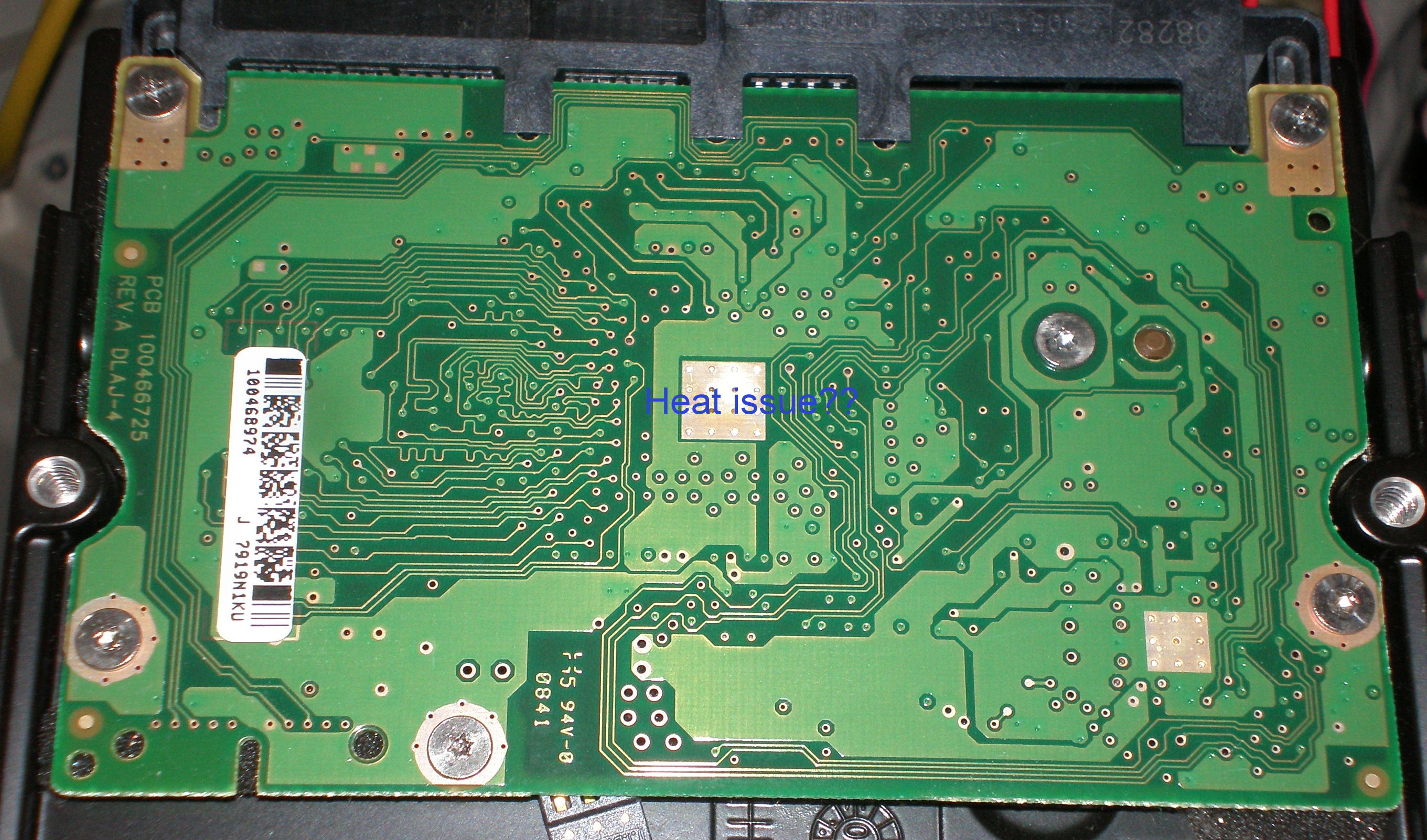

It shows up in the bios in 3 different mach, will not show up with any of the data recovery software i have tried on it. It did show up for about 30 seconds or so when I was holding it at a weird angle but then I took a breath and it went away. I put a hard drive fan on it thinking that it was getting too warm but it did not help. I have a camera tripod that i could try to use to keep it in the same position but not sure how to mount it to the base. Has anyone ever had this happen. It seems like there may be some heat issues based on the drive controller. See pic

by: azadisaryevPosted on 2009-11-04 at 11:13:15ID: 25742766
did you try SeaTools for DOS on it?
it's the second one on this page: http://www.seagate.com/www/en-us/support/downloads/seatools
by: ISoulPosted on 2009-11-04 at 11:41:55ID: 25743057
If it is a heat related issue where the drive can only be accessed until it gets too warm, then you could always try the freezer trick.
Wrap it up in a plastic bag, put it in the freezer for a couple hours, take it out and try to recover files from it immediately.
by: mikebesurfingPosted on 2009-11-04 at 12:43:29ID: 25743679
I just tried that version of Sea tools and it did not see it.
I don't know that the freezer would work as it wont see it at all unless it's at the right angle.
I am going to try a bag of sand to set it on to get the perfect angle so maybe it will stay long enough to get the data off.
by: azadisaryevPosted on 2009-11-04 at 23:55:00ID: 25747467
try using different sata connection cables - could be faulty cables or connectors on disk/mb...
if that does not work, get an external usb/firewire sata-2 enclosure and connect the drive as an external usb drive to a computer - this may help if mb connectors are screwed up.
Azadi
by: mikebesurfingPosted on 2009-11-05 at 07:39:17ID: 25750614
I tried the freezer trick for about a hour last night and it did not help. I have tried different connectors as I have tried it on 3  different mach. and different cables. I have also tried it with using the jumper to slow it down to the 1.5  I am going to try it again now that it has been sitting for 10 hours or so.  I have 2 different usb adapters neither of which I can find at the moment.
by: mikebesurfingPosted on 2009-11-05 at 07:42:05ID: 25750649
I also tried a bag of grass seed to try to get that perfect angle last night also it did not help.
by: coley467Posted on 2009-11-06 at 03:40:06ID: 25758267
Is the drive spinning when you've got it plugged in (you can usually hear it) or only when its accessible? Could be your power connectors, or maybe if you're using the same sata power converter cable in all the different machines if its not spinning up all the time.
by: mikebesurfingPosted on 2009-11-06 at 22:49:25ID: 25765229
It is spinning all the time that it is plugged in, it did show up in xp but then the proprieties of the user folder is 0 files. I tired all I could do I even had found my usb one, muti cables 3 mach no help.   The customer had to get it shipped back or he would get charged a core. The data was not critical but would of been nice. Thanks for all your suggestions.
