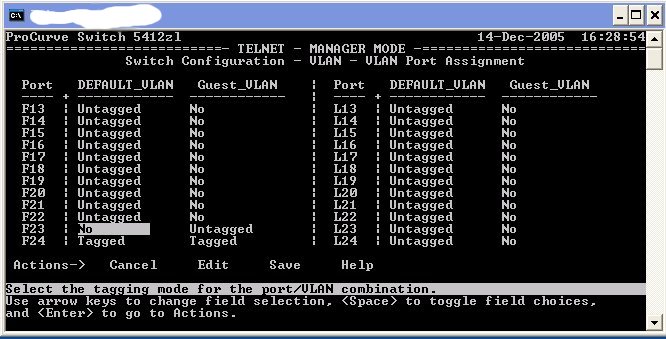

by: Rowdyone52Posted on 2008-04-30 at 18:44:38ID: 21475958
Those articles helped out a lot.  I think I've got the switch part figured out.  As a test I put one port in a new vlan then I tagged another port on both vlans.  When I connected the router to the shared port then there was no network traffic flowing from the switch to the router.  Do I need to configure the router with 2 sub-interfaces for both vlans to get connectivity.
Please someone look at the attached screen shot and let me know if I have the switch configured right.
by: jburgaardPosted on 2008-05-01 at 03:32:49ID: 21477513
My guess is that when connecting HP and Cisco you need to make the HP-side untagged on the DEFAULT_VLAN 1.
So here, as the link to Cisco seems to be F24: Untagged DEFAULT_VLAN and Tagged Guest_VLAN.
(when connecting HP to HP you have a little more freedom in this regard)
HTH
by: Rowdyone52Posted on 2008-05-01 at 07:32:15ID: 21478957
Ok, thanks for the info jburgaard.  That fixed my problem with the main network not being able to access the router.  Now I have both vlans up and running.  However, there is one snag.  the vlan for public use (vlan_guest) is able to access my entire network.  How do I block access to the 10.10.x.x network and to the 10.11.x.x network from the public network?
