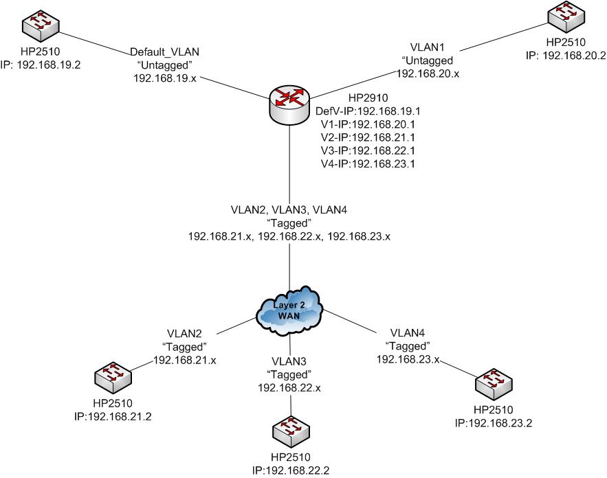

I am trying to change our network from one gigantic LAN to two different LANs and then also incorporate our WAN with the same switch.
I bought an HP procurve 2910 with the hopes of being able to segment the LAN and then have it route the incoming WAN.  The WAN is metro-E, so its like one gigantic LAN that spans accross the state.  I can assign any IPs on the WAN.  Right now i am using a 192.168.254.0 network.  Each firewall at the remote sites has its own external ip on the 254 network and then an internal network in the 192.168.2x.0 range.
I am looking for a way to program the HP procurve here so that the single cable coming from the fiber tranciever for the WAN network is able to route each of the WAN networks.  I also want to segment the main network into two networks using the same switch but on a different port(obviously).  I just have to make sure that all the networks can talk to one another.
I would also like to have separate VLANs for voice and data coming from each site.  Maybe even a third VLAN for switch management.
If you need more details feel free to ask.. i wasnt sure what else to include.  I am hoping the diagram will help alot.

by: pwindellPosted on 2009-08-11 at 13:18:32ID: 25072907
Don't "go crazy" creating new IP Segments.
It is fine to:
1. have a different IP Segment for each physical geographical location
2. have a different segment for the phone system (Voice)
3. have a new segment for every 254 Hosts (24 bit mask)
4. have a new IP segment to separate machine due to security where you can use ACLs at the Router
And that is about it.  Don't go crazy with it.  I did once and regreted it,...and it is very difficult to "go back" after you make a mess with it.  Even the #4 above is usually way over done and needless,..there is a whole lot more to security then Layer3 and it is very rare (in my opinion) that #4 above is done for the right reasons.
Do not create a separate one for management of the switches.  The "management" creates next to nothing for traffic in the grand scheme of things and creating a new segment for it is needless complexity.  There is no performance gain anyway if you end up running two or more IP Segment over the same physical "wire",..the wire is only going to go so fast and it does not care at all about your VLAN config.
Switches are not Routers.  If it is a Layer3 switch then it is really a Router and a Switch combined together into the same piece of hardware,...it is a hybrid,...but you must mentally treat them as two separate devices depending on which functionality you are dealing with at the moment.
Now with that out of the way.....Only the 2910 is L3 capable. The 2510s are L2 only.  So the "VLANs" will only exist "in side the housing" of the 2910.   Yes, you could run multiple VLANs over the same wire to run two IP Segments over one of the 2510s,...but don't,...your are overloading the "wire" and gaining nothing but needless complexity.  You may still run multiple IP Segments over your WAN "wire" anyway, but that is just the way it is,...so don't make it worse.
Sounds like your WAN is Layer2 only so it does not care what IP#s run over it so all you do is create 4 VLANs (that gives you 5 counting the Default_VLAN).  The Default_VLAN and one of them you create will be at your local Main Site.  Assign a set of Switch ports for each of these (set as "untagged").  Then set the last three LANs to one of the ports as "tagged" because you will (unfortunately) have to run those three over the same "wire" due to the WAN.
Example:
  Tagged = responds on a VLAN by reading the Tag
  Untagged = responds on a VLAN by virtue of the physical cable (ignores Tags)
   No = does not repond to packets from that VLAN at all
1-12 for Default_VLAN = "untagged"
13-23 for VLAN1 = "untagged"
13-23 for Default_VLAN, VLAN2, VLAN3, VLAN4 = "no"
24 for VLAN2, VLAN3, VLAN4 = "tagged"
24 for Default_VLAN, VLAN1 = "no"
Then cable the WAN into the port23 on the 2910
On the other end of the WAN at each location configure each 2510  with a management IP# assigned to according to the IP Segment that it is supposed to be.  Then configure it with all of its ports set to "tagged" with the correct VLAN ID for that Site.  "Tagged" is needed because the incomming "wire" will have all three VLANs running on it at the same time with the only way to distinguish them is via the Tag.  Set all other VLANs to "no".
I did a "quickie" diagram to help illustrate what I mean:

Thats a good start.. how would i then go about programming the 2910 to handle and then route the different VLANs coming in from the WAN connection?
I believe all it amounts to is first set the IP Specs of the device,..then creating the VLANs within the 2910's config and then enabling the Routing.  The rest takes care of itself.  The VLANs you can create with the Web Interface,...but I believe you have to enable the routing from the Command Line Internface.  Double check that with your Docs for the device,...mine (a 5304XL) was a different model and it has been a long time since I did it.

Because it is a Hub & Spoke design,...every IP Segment is "directly connected" to the central router,...meaning the router already "knows" about them,...hence,...there are no "routes" to setup.  You only setup routes for IP Segments that are more than one hop away from the router you are dealing with.  If you use dynamic routing protocols (like RIP and other) then you don't even have to worry about that.  Another way to explain this is that routes point to routers,...you only have one router in the "center",...therefore there is no other router to point to,...therefore there are no "routes" to create.
The Internet connection was never discussed.  This has to be considered.  The difference will be in whether or not each site independently goes to the internet with their own independent firewall or if all sites use a common single firewall at one location.  This is important,..no overlook it.

Ok, i see what you mean by hub and spoke with this thing.  I was able to get the 2910 routing between local vlans.  Took me a few hours to figure out how to assign the IPs to the VLANs, then setup the default route and add ip helpers for dhcp.
I essentially created two ports on the router for three different networks(segments).  Here is the more imporant part though.  Your visio example is great, that helped me wrap my head around the concept and apply tagged vs untagged.  I also did some searching on some other features the hp switches have.
The last issue i need to work out is the remote sites.  The three segments i created are locally connected to the switch and mainly meant for segmentation.   What i need to work out is the remote sites.  In your example you have one tagged vlan.  What i need are three vlans( one for voice, data, and secure wireless ).  If i set the ports on the 2510s to be untagged as say vlan 5(voice), vlan 10 (data) and vlan 15 (wireless) for each respective type, when i hook that cable from the fiber to the switch, does that port need to have each vlan assigned to it and set as "tagged"?   If so, what about ports that are not apart of any vlan but the default, do i need to do anything special with those ports?
Also, if i have that single uplink to the fiber port with the three tagged vlans on it, will all the broadcast traffic from each vlan be sent acrross the wan? ( i assume so, just want to be sure)  If this it the case, should i go ahead and enable routing on the 2600 units and use those as gateways to WAN?  I would essentially be using them as routers but they would route locally.
Attached is a diagram of what i was thinking.
I will say after putting it to "paper", i think it would make more sense, if the broadcasts are going to traverse the wan, to use option B.  Yes i have to setup routes in the main router for each remote subnet, but it would segment the traffic locally and block broadcasts.  Not to mention the VLAN configuration involved with option A would be large, possibly outside the capabilities of the 2910 in the future assuming each site adds three vlans.
Thoughts?
by: IcetoadPosted on 2009-11-04 at 15:33:44ID: 25745337
Thanks for your input, i am going to close this now, we are up and running.  No VLAN accross the WAN because of broadcasting issues, just routing :)

That's what I would have done too.  I never would have done those VLAN unless I was really truly forced to by the situation.  Marketing often says VLANs make things simpler,...I think it usually doesn't except in certain situations.  Marketing often does not live in the real world,...Marketing just wants to sell you something.
