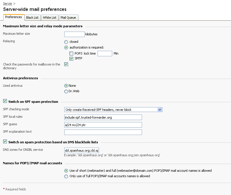

We do have a vps using plesk.
Ive just checked all setting on the mail server.
Do the settings in the image attched look ok?

by: alanhardistyPosted on 2009-09-03 at 15:41:05ID: 25255616
Looks okay on that part - would be interested to see the rest of the DNSBL's that you are checking against and also if the SPF could be blocking him based on his email address / IP address combination.
Your ISP should be able to advise you on that more.
I just implemented a country block list on my mail server - so far Brazil, China and Czech Republic are on my hit-list as they send me plenty of unwanted spam.
by: SWHostingPosted on 2009-09-03 at 15:45:02ID: 25255646
Here is the full list.
sbl.spamhaus.org;xbl.spamhaus.org
As far as I know the client is in europe somewhere.
by: alanhardistyPosted on 2009-09-03 at 15:50:05ID: 25255674
Okay - those don't block by country - they just list by IP's that have spammed so they should be fine.
