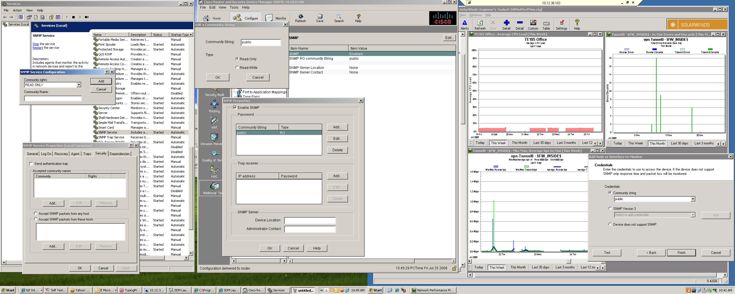

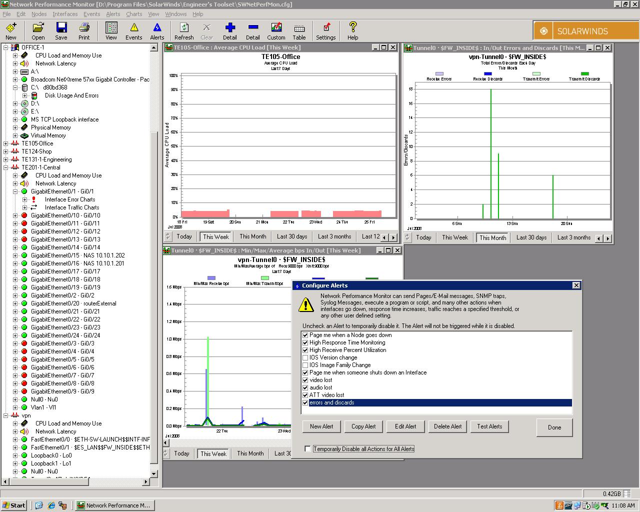

by: dkarpekinPosted on 2008-07-25 at 07:54:24ID: 22089114
Most of the devices have  by default "public" for retrieve SNMP info, and private to set parameters.
www.solarwinds.com
  can give "trial" to test , as many others.
In picture is example :
on a left side- how to set SNMP in Micrsoft box and Cisco2811
on right side - how this SNMP used by Solarwinds to retrieve SNMP , and present it graphically, as well to add new SNMP device base on "public" SNMP string.

some more for cisco switch and solar winds.
Alerts can be configured to send message, once it is triggered, by e-mail, winmessenger....
