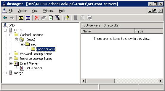

Burns2007: using ipconfig /flushdns on several computers and still getting the same problem. Checked on the server in DNS management, and under cached lookups > .root etc all these are empty, there are no records? I have attached a screenshot for reference.
Kutyi: Tried clearing the cache, then ipconfig /flushdns, still getting the same problem.

by: icorpsPosted on 2008-03-06 at 16:46:50ID: 21066261
Are you able to access the site from other locations?  Its possible they change ISP's or something and never had the old ISP stop answering the DNS lookups.  Do you have forwarders set on your DNS servers?

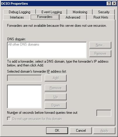

icorps: Please explain more about forwarders, and steps to get to there? I have attached another screen that i got to by clicking on DC03, then clicking on Forwarders:
Thanks heaps all for the responses so far, i am learning a lot about DNS and look forward to resolving this issue.

Based on that screenshot, you are not using any forwarders.  So its just using the root DNS servers, which should resolve to the correct site.
As Laserspot said, check the hosts file.
