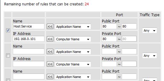

by: turbot_yuPosted on 2009-07-29 at 07:49:50ID: 24970738
I tried to set the port forwarding after login the router.
The setting is in the screenshot.
Now I can visit the dns from home at the same pc.
But at the office, I still cannot vist it.
Any suggestion?

by: StrifeJesterPosted on 2009-07-29 at 12:21:55ID: 24973603
Did you switch the management like mentioned. You will need to make sure the router is no longer listening on 80. Also what web server are you running?  Sometimes the web service has to be told what interface to listen on.  Take IIS for example you can make it listen on only 192.168.0.101.  Without fixing this it will ignore the requests that come in on your external IP because they will be address to that IP not 192.168.0.101.  I know also that WAMP will run fine from inside of a netwrk but you have to tell it to go "online" to accepts requests from the outside world.  If you are unsure of how to do this on the web server let me know and I can look into it if isn't a server i am familiar with.
