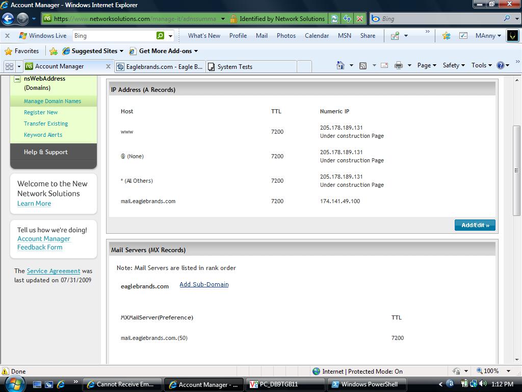

by: manny_lenisPosted on 2009-09-26 at 10:15:04ID: 25430418
this is what my dns settings look like on network solutions.

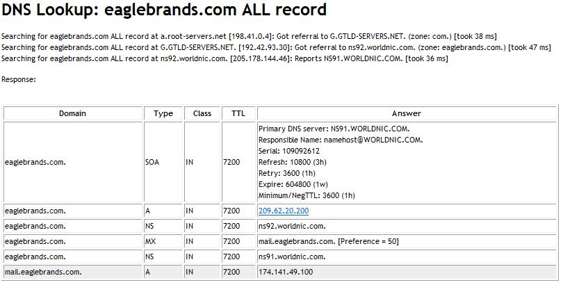

by: alanhardistyPosted on 2009-09-26 at 11:02:30ID: 25430629
See the attached
by: alanhardistyPosted on 2009-09-26 at 11:03:49ID: 25430638
It is buried in your DNS somewhere.
by: manny_lenisPosted on 2009-09-26 at 11:13:39ID: 25430733
dont understand why that A record is pointing over there.  network solutions has it pointing to 174.141.49.100. let me reset all dns settings to their default and start from scratch.  Im logged on to postini but dont see where to change the server info.

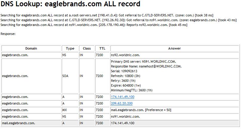

by: alanhardistyPosted on 2009-09-26 at 11:26:52ID: 25430841
Now I'm seeing this:
