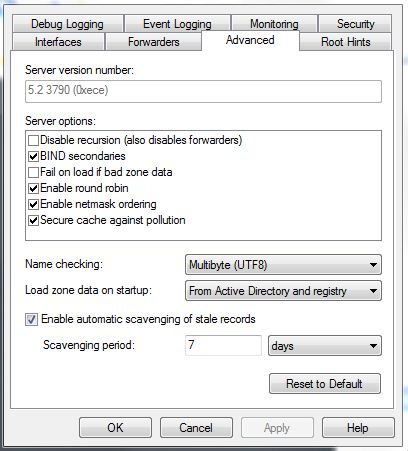

by: SmallPrintPosted on 2009-11-03 at 12:19:48ID: 25733109
It was not checked.  Any difference between days? Since this has never been scanned i assume i will have to wait 7 days?  Any harm if i choose 1 day?

by: DrDave242Posted on 2009-11-03 at 12:38:38ID: 25733334
No, I can't see that there would be any harm in setting the period to one day.  If you do so, any old records (whose no-refresh and refresh intervals have passed) should disappear 24 hours after you click OK or Apply.  After that initial scavenge, you can set the period back to 7 days...or I suppose you could leave it at one if you choose.
by: SmallPrintPosted on 2009-11-05 at 08:05:22ID: 25750886
Does this mean 56 entires were cleared up?
by: DrDave242Posted on 2009-11-05 at 09:43:35ID: 25751926
There were 54 stale records scavenged from your server, but I don't completely understand nodes vs. records, to be honest.  I've had trouble finding a detailed explanation of exactly what a node is.  What I've read says that a node represents a name in DNS, and each node contains all of the records associated with that name.  That makes sense, I suppose, but I don't see why you'd have more nodes scavenged than records.  That implies that there were nodes inside your DNS with no associated records.  This isn't outside the realm of possibility, but I don't know exactly how it could come about.
Regardless of all that, scavenging completed successfully on your server.
