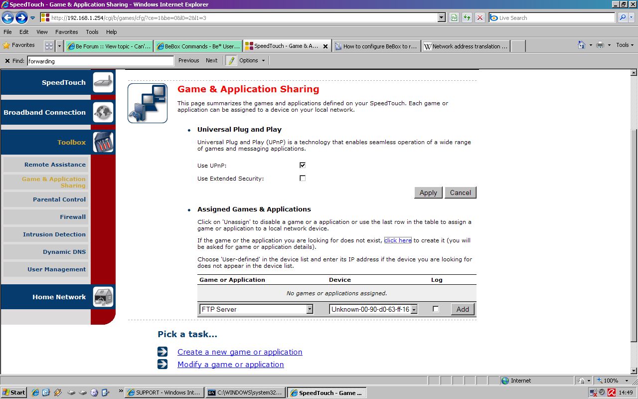

Well i have this utility on my BeBox menu (see attached). Im not too sure how i'd configure it, any thoughts? many thanks
by: nociPosted on 2009-10-22 at 08:10:46ID: 25635136
That might be the right option (although i would expect an IP address there not a MAC address.)

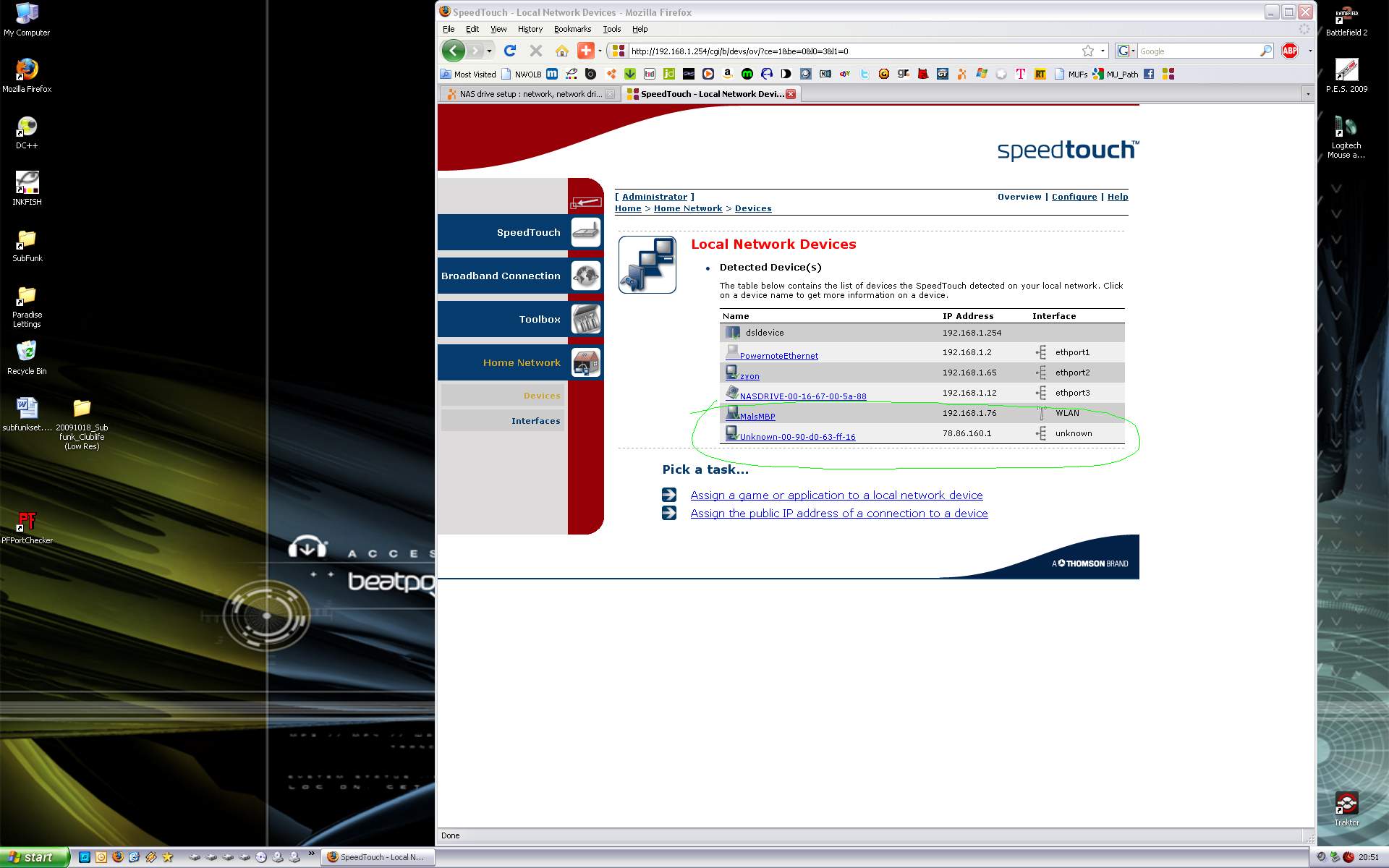

I always seem to have this Unknown Device connected to my router (illustrated in attached image and circled in green). Could this be the problem with the connection to my NAS?
by: nociPosted on 2009-10-22 at 16:07:26ID: 25639988
the unknown MAC address (00:90:d0...) has address ... 78.86.160.1 is your default gateway (needed to access the internet... its name is not published..)

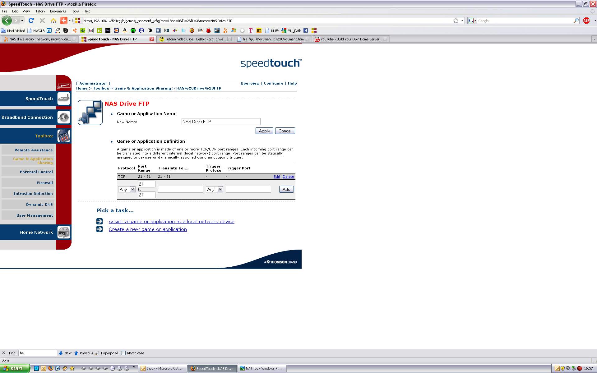

Don't add a new service, FTP is port 21, but needs extra handling because it has more channels at different ports for the data transfer. So you need to use the EXISTING Fftp, and in the Device box select your NAS.

by: Mal_kPosted on 2009-10-22 at 17:46:36ID: 25640490
OK... thanks.. i did think  that the mysterious mac address was my external gateway... honest...
i have followed your instructions using the built in FTP application selectable from teh drop-down menu and then selected my NAS drive from the device list from within the router gui...
When i try to connect via firefox ftp it comes back with: Alert 530: permission denied... i imagine thats because im trying to access the external gateway via the internal, right?
I will try tomorrow when i can get to a pc outside of my LAN.
Many thanks... heres hoping! I'll post back my findings...
