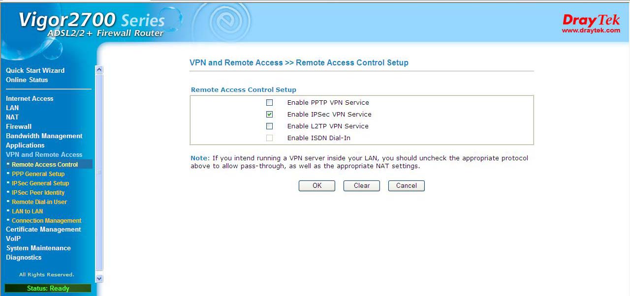

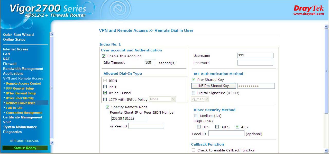

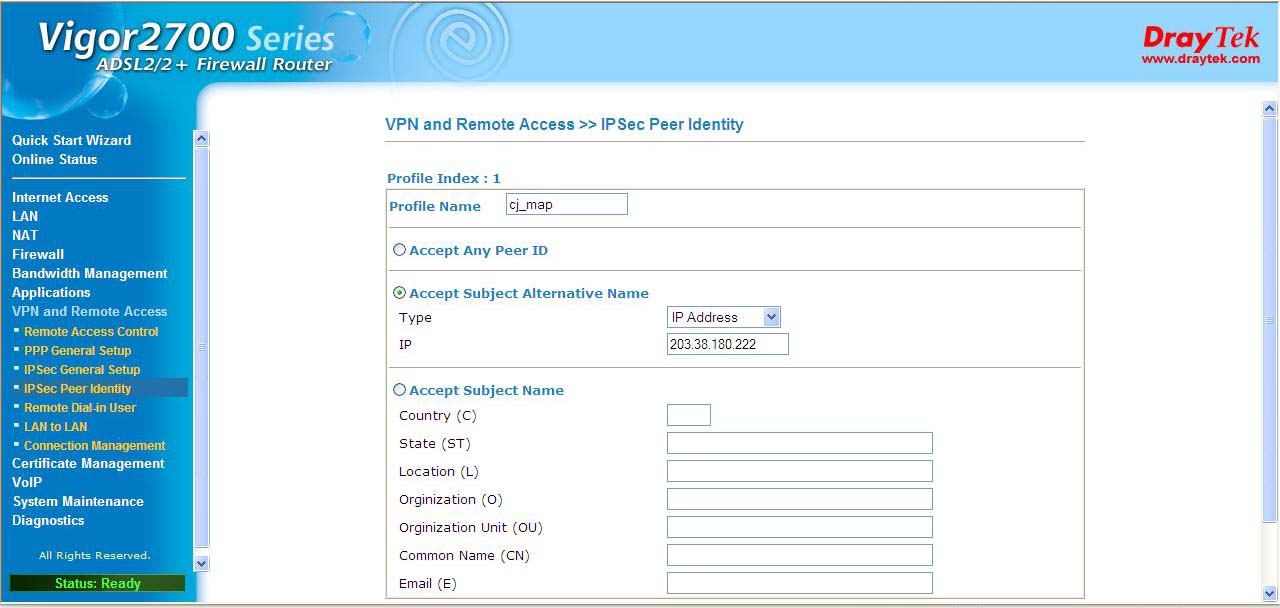

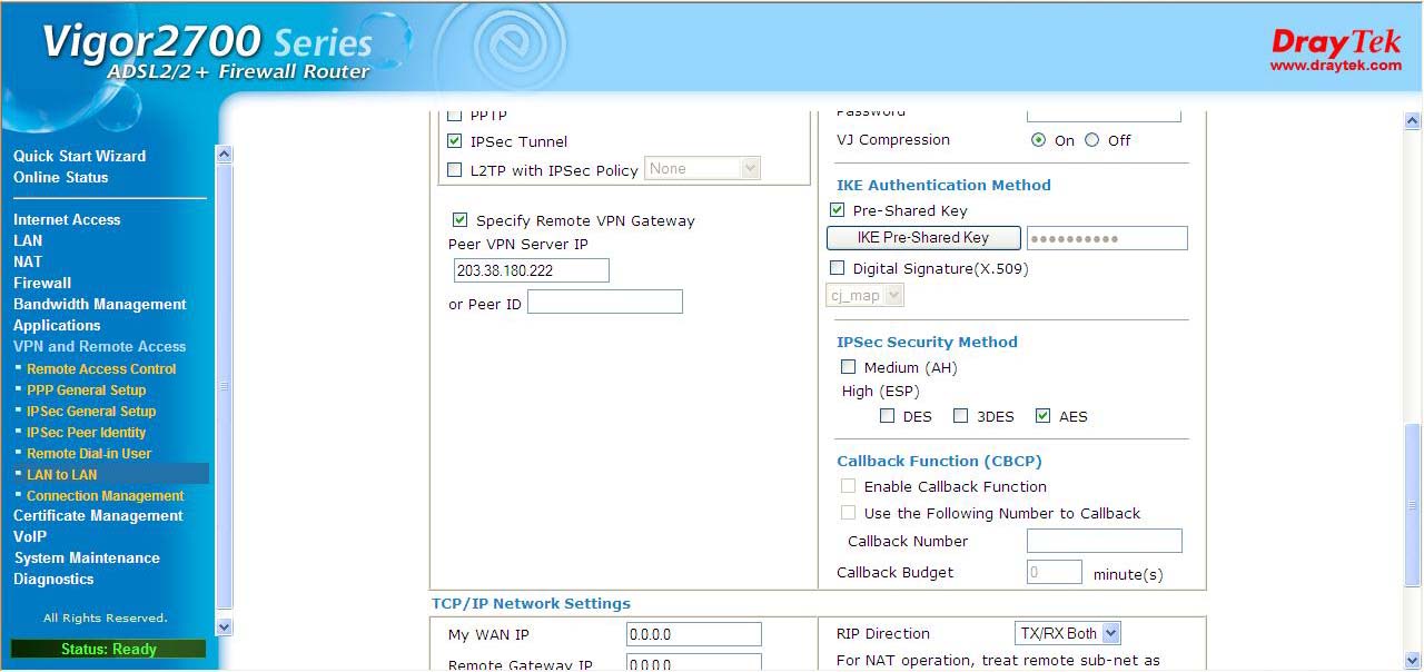

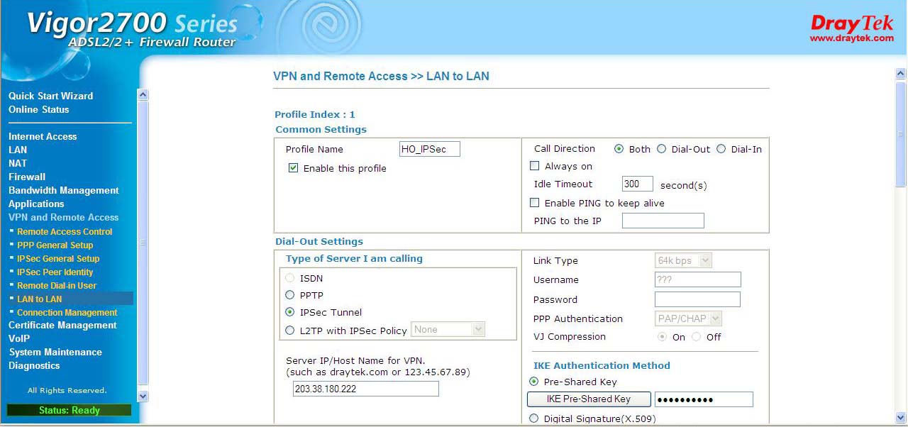

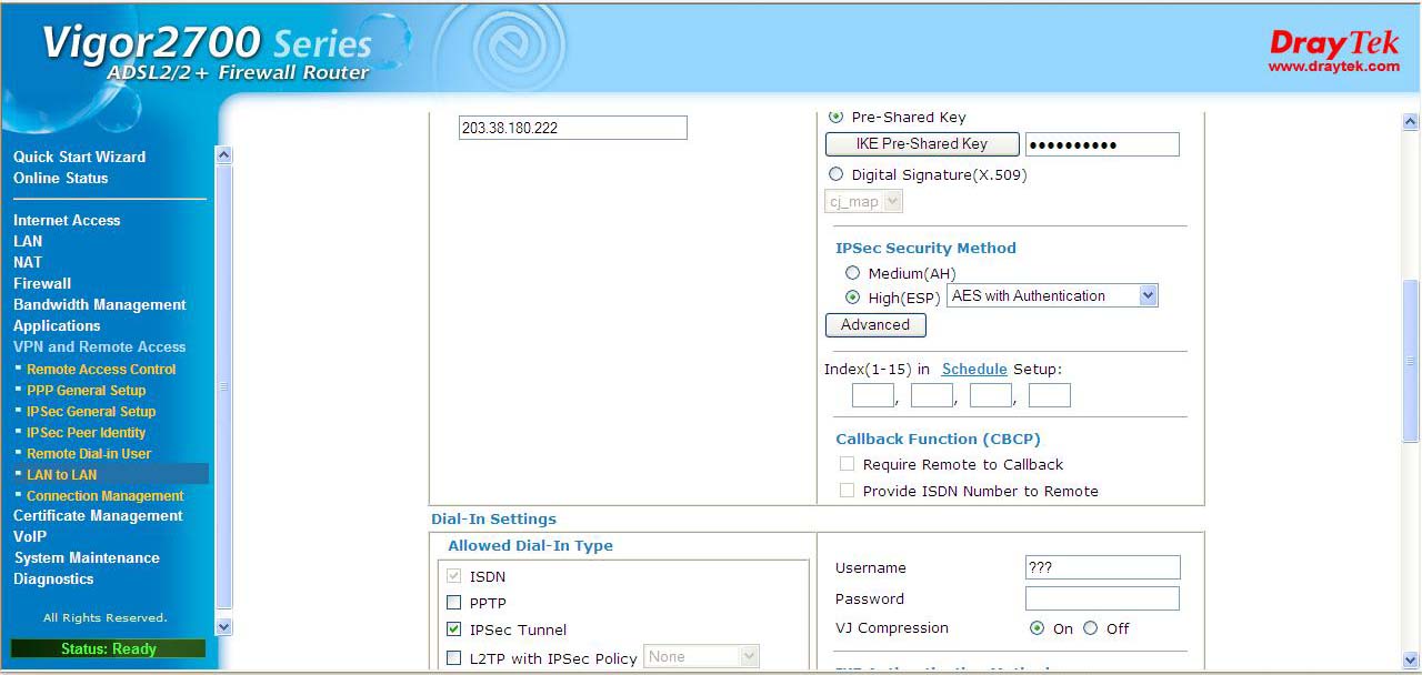

I am trying to configure an IPSec tunnel between a cisco router and a draytek vigor 2700 series router. However, they don't seem to be negotiating Phase-1 parameters. I have throughly checked my settings in vigor and cisco which seem ok to me but i'm missing something in phase-1 parameters (possibly in the vigor 2700 series) which is why its not establishing the tunnel. Given below is an output of show crypto isakmp on the Cisco router
VPN-Hub#sh crypto isakmp sa | section 165.228.142.37
165.228.142.37  203.38.180.222  MM_NO_STATE          0    0 ACTIVE
The config for cisco router vpn is given below and ive attached snapshots of the vigor...Your help will be really appreciated !
