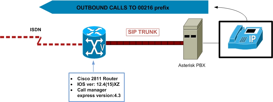

Hello every body
my cisco call manager express is trunked with an asterisk server, i want to route the outbound call coming from the asterisk server (called number with the 00216 prefix) via my cisco call manager express to isdn link , how can i configure my ccme to do it
Look at the figure below

As long as you have a dial-peer on the CME router that sends calls with the 00216 prefix out the ISDN link, the CME should route the call.  Maybe something like this:
dial-peer voice 1 pots
 description ----------------> PRI Local Calling
 destination-pattern 00216
 incoming called-number .
 direct-inward-dial
 port 0/1/0:23
Is this what you need?  Let me know if you need more information.
David
by: jamillPosted on 2009-03-16 at 09:52:56ID: 23899780
thank you very much it's working
