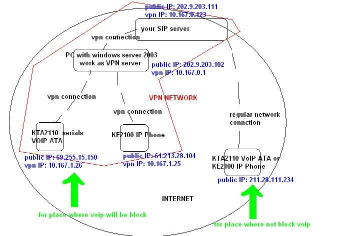

by: westdataPosted on 2009-03-31 at 04:12:33ID: 24027529
Thank you very much for your detailed response, I understand the solution you gave. However, I was thinking about a setup like that in the picture I have attached. Please have your look.
I am thinking to get a dedicated 2 MB line here locally, connect to a SIP server (Locally or at remote location, which one you'd recommend?) Then my clients in Middle East would dial my VPN server, and relayed to the SIP device that will complete the connection.
Regarding the solution you have recommended, I have read and experience degraded QoS and ACD when using OpenVPN. The PPTP/L2TP would work fine....
P.S : I am not really a network literate, just know a few things by experience.....bear with me

by: Roachy1979Posted on 2009-04-01 at 04:19:01ID: 24037880
Ok....the best way to achieve this largely depends on the volume of "internal" calls as to whether you use an internal or external host, and also how comfortable you are with troubleshooting VoIP issues (which can involve packet capture and analysis).  Remember - if you host your own VoIP server then if there were problems with calls between your extensions would need to be able to troubleshoot yourself....
If you have a high number of internal calls then the way forward is probably to host your own SIP server (which in turn connects to a 3rd party server to connect externally to the PSTN network).  Otherwise you would be kicking the traffic out of the internal network to a 3rd party to then have the calls routed back in - which would double your bandwidth requirement for those calls.  But again this depends on your desire/ability to support it....
Does this help at all...?  No problem with not being "network literate" - looks to me like you're doing pretty well :)  And after all - that's what EE is for :)
