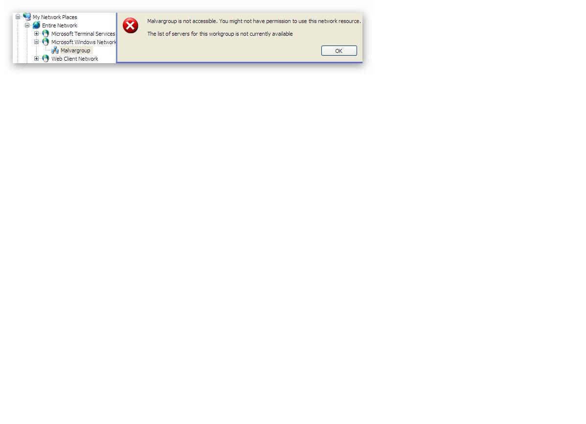

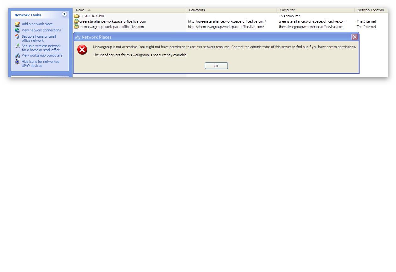

I can see Malvargroup under NETWORK on the XP Windows Explorer (there are three folders under the Network Icon.  One is "Microsoft Terminal Services" (there is nothing in that) the other is Web Client Network (nothing in that either) but in the middle there is the Microsoft Windows Network and when I click on that (or expand it) I see Malvargroup Icon (three small monitors on the icon) When I try to expand it to see below, or click on it to see what's inside on the left side of Windows Explorer I get this error: Malvargroup is not accessible. You might not have permission to use this Network Resource. The list of servers for this workgroup is not currently available,  SO... I stuck out on the XP>
On the Vista, I see different Icons in Windows Explorer.

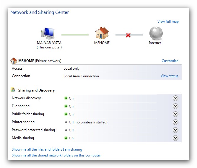

Under Networks I actually see both system's icons and their names ... I can see MALVAR-VISTA with all the shared folders I created for the VISTA underneath and accessible.  HOWEVER, under that I can see MALVAR-XP, but that one is not working and I get the error that says Windows cannot access Malvar-XP Check Spelling or there may be a problem with your network.
Anyone have a solution?  I turned Firewalls off and then on... I do not have any firewall software (I use AShampoo Antivirus which is very basic and I have nothing else that is unique.

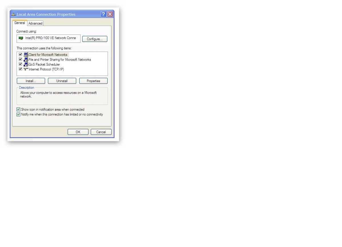

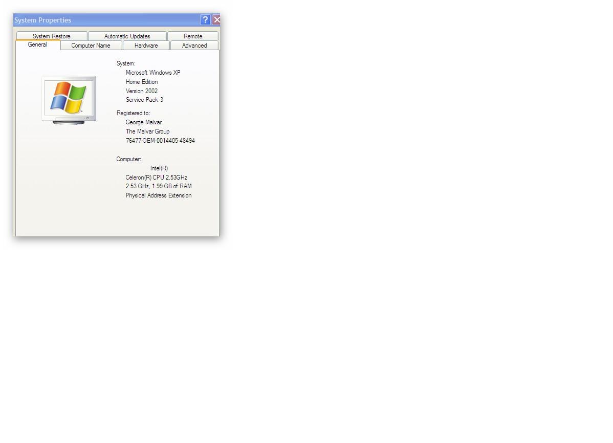

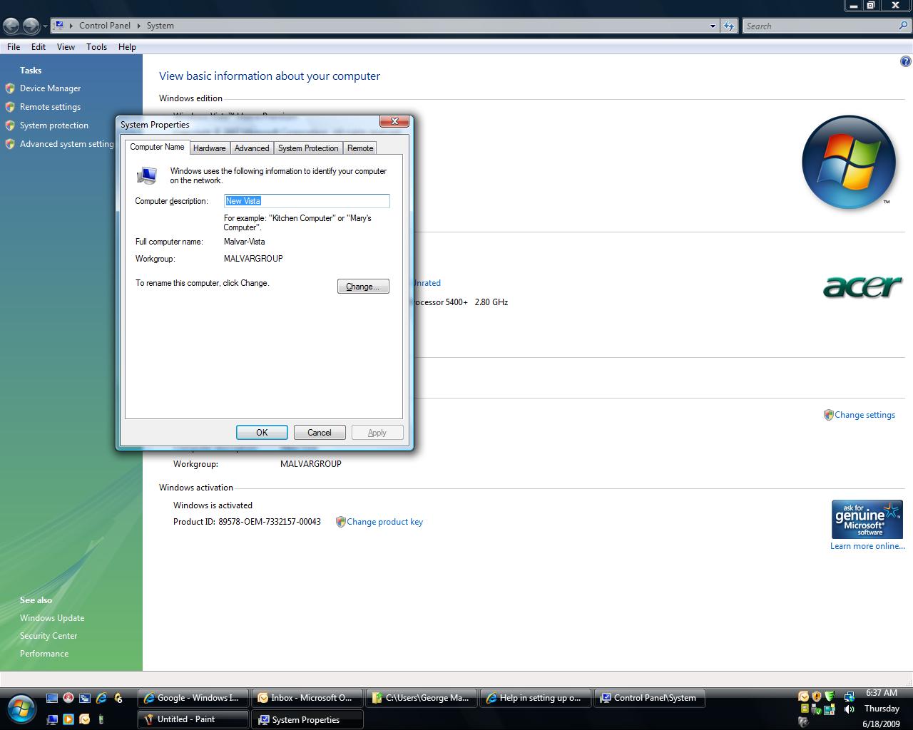

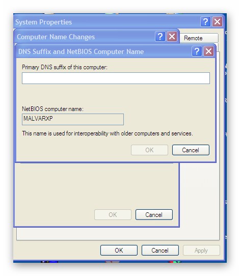

First, on the XP system, right-click on My Computer;  select Properties;  click the Computer Name tab;  press Alt-PrintScrn;  open the Paint program (Start - All Programs - Accessories - Pain); and select Edit-Paste.   Then save that as a .JPEG and attach it here.
Now do the same on the Vista system ==> right-click on Computer; select Properties; select Advanced system settings; click on Computer Name; etc.    ... and attach it here as well.
Just want to be CERTAIN those settings look okay.

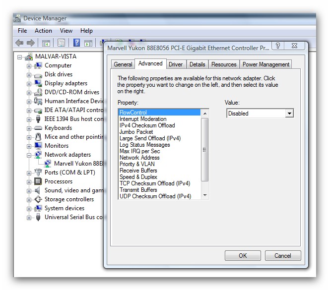

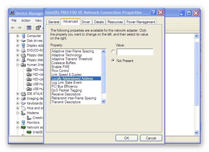

Now on the XP system go to Control Panel - Network Connections.   Be sure that window is highlighted and do an Alt-PrtScrn for it -- save it in Paint, and attach it here.
There's more I want to see ... but first post those three pictures.

by: freedomwatchdogPosted on 2009-06-18 at 03:44:44ID: 24656112
Here's the Vista - The XP almost exact except for names - Did you see my question about login?
Do you still need XP? I'll send it from that one (I cant access it from here yet (obviously)
I added old text because I thought that's what you DID want.  I am sorry.

I named each computer - Malvar-XP and Malvar-Vista... One appears system in CAPS and the other doesn't (is that an issue?)  I don't think I used caps lock, but if I did on the naming of each or the other, will that hurt?  Do it again?
I named the network Malvargroup (same issue with CAPS - XP shows it with Caps XP does not ?  do it again? with NO caps anywhere?
I clicked on seven to ten folders (or so) from each system and put them on "Share" and "Allow others to change"
In Windows Explorer: On the Vista, I see both network system names MALVAR-VISTA with the sub folders below and MALVAR-XP but when I click on that one it gives me the misspelling or wrong configuration error and I see nothing at all below it (folders from XP shared)
On the XP, I see Microsoft Windows Network and I see "malvargroup" network icon below (three monitor icon) but when I click on it I get the error that it cannot access that network (see above comment in another box above)  I do not see anything else.

One other item ==>  do a screen capture of the Network and Sharing Center screen that shows all of the settings currently shown in the bottom section labeled "Sharing and Discovery"
by: freedomwatchdogPosted on 2009-06-20 at 23:02:57ID: 24676340
Hello again;
I can't thank you enough!
I wish there was a way to do more for you...
Here are the images...
I couln't find a way to do a Save as picture to My Pictures from an emailed picture on Outlook Express! I only got the option to copy! Odd!
Here's the ones from the XP plus an extra one showing my windows explorer view (ignore the error, I think it's from the line below Network by mistake)

I also added a few more images... I see in properties of TCP/IP that one is disabled...?
I thank you again!

Also, which versions of XP & Vista are on these systems?     Right-click on My Computer (XP) and Computer (Vista) and select Properties.   Note the exact version and any service packs that are applied and post them here.

The XP (The culprit - I think) is this:
Windows XP Small Business Edition - SP 3

I can see everything with NO problem from the Vista LapTop - But I am still frozen on accessing the XP from either of the two Vistas.
Here's more on the XP that may help:
I noticed on the Device Manager that the top setting was not enabled - a TCP setting (see image) The other images are related to screen views and Windows explorer views regarding the network we names MalvarWorkgroup which is NOT being picked up nor will it even open to show me anything below it in XP's Explorer.
Let see what we can do from here... I am serious about paying for your services plus the points - I have gone way too far and feel obligated. Please let me know if this is OK and allowed, or send me an email if that's allowed too.

"... The XP (The culprit - I think) is this: Windows XP Small Business Edition - SP 3  " ==>  Actually, it's XP Home Edition (w/SP3).   ==>  This is likely where the settings are incorrect.    There are a couple of key differences between Home & Pro that may be at play here:   Home uses a different sharing model (simple file sharing is enabled by default); and has a 5-connection limit for active TCP/IP connections.     It also defaults to an "MSHome" workgroup -- which is what you're seeing here ... so this may very well be what's set wrong.     On the XP system, right-click on My Computer;  select Properties;  click the Computer Name tab; and see what it shows for the Workgroup name.     If it's not "MALVARGROUP" click on the "Change" button and change it to that.
After you've confirmed that, we'll look at a couple of other settings if it's still not working.
by: freedomwatchdogPosted on 2009-06-28 at 19:39:50ID: 24733390
I had to leave on a business trip and had a very tough time while I was away trying to access (Go to My PC) was a little help...
In any case, the name on the XP is and has been MALVARGROUP.  I entered it in CAPS Lock, because all others show it in caps . I then went back and entered it en regular text...  Here is a picture of that setting.
II still cannot access the XP system from itself or any other computer, including my Vista and my daughter's lap-top, but each of them can see each other.
If there are TC settings (or whatever)  Please tell me when to go to set up any possible setting to make this XP get noticed on the network because EVERYTHING we need on those other systems in in the XP!
I thank you and I will make this worth you while because you are going above and beyond to help me!
I wait on your reply.
Again, I had to go from Ocala, Florida to Nevada for four days and I just got back.  I hope we can fix this once and for all.  Below is the image for the settings you requested,
THANK YOU MORE THAN YOU CAN IMagine...
By the way, no matter what little thing I see that I try, I still get the error that says"  "Malvargroup" is not accessible ... You might not have permission to use this network resource ... Contact administrator (? is this an area needs looking into? - (I assume that I am because I am the only user and in The Users area, George Malvar is and gas Administrator designation)  ... finally on the error window it says ... The list of servers for this workgroup is not currently available...  It pops up like a bold error with a big ROUND RED X and a loud bang! (or gong)  That's what I've been hearing and seeing each time I click on the MALVARGROUP icon in Network places under the Windows Network Icon (the icon with three monitors)  ... But remember, I can see MALVARGROUP from the Vista and Vista Laptop.
by: freedomwatchdogPosted on 2009-06-28 at 19:45:18ID: 24733402
Ooops forgot to mention what I am trying to say with the two images that I think are strange... the first one shows a value that's blank (that may need a number or setting?
The second image in the same:  It's where the computer names are initially entered.  When it said next this time (usually it just says close) I noticed the DNS suffix was blank... do I enter anything thers...
That;'s it on this one.. Remember the big stuff is before this afterthought.  By the way, this info is on the XP... I think the VISTA is fine (It appears to be based on the laptop picking it up... It's the XP that won;t pick up the network or even recognize itself.
