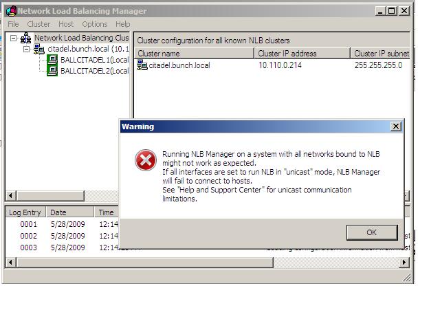

I have set up a pair of Windows 2008 Servers with NLB and I am getting this error when opening the Network Load Balancing Manager: "Running nlb manager on a system with all networks bound to nlb might not work as expected. if all interfaces are set to run nlb in "unicast" mode, nlb manager will fail."
I have only one NIC per server however the NLB is in Multicast Mode.  I thought I didn't need more than one NIC with mulicast and it seems to work correctly.  Why would I get this error and should I be concerned?

No need to be concerned if the cluster is running in multicast. Be aware, though, that when using multicast, usually only hosts in the cluster's subnet are able to access the cluster address, because most routers don't publish multicast addresses; you'd have to create static ARP entries for access from subnets.
by: zarniPosted on 2009-05-28 at 12:02:22ID: 24496731
We will be forwarding traffic from outside the LAN to this server.  I am thinking we would not have to worry that it is not published.
Is that error just a generic message then?  Any way to disable it?
by: oBdAPosted on 2009-05-28 at 12:31:18ID: 24497029
Did you perhaps create the NLB cluster by checking the "Network Load Balancing" box in the TCP/IP properties? If so, then remove the NLB cluster again, and re-build it using only the NLB Manager.
by: zarniPosted on 2009-05-28 at 13:03:55ID: 24497321
No, I installed NLB and used the manager to create the cluster.
by: oBdAPosted on 2009-05-28 at 14:14:19ID: 24497912
Next thing I'd try is to remove the cluster, reboot the machines, and recreate it. If the error still comes up, I'd remove the cluster again, uninstall the NLB protocol, reboot, re-install NLB, and try yet again.
by: zarniPosted on 2009-06-02 at 11:03:19ID: 24529617
After some research I found that this error happens even if you have the servers in multicast mode.  Not sure why but they do recommend administering the NLB from another server if you only have 1 nic per server.  Maybe that is why.
