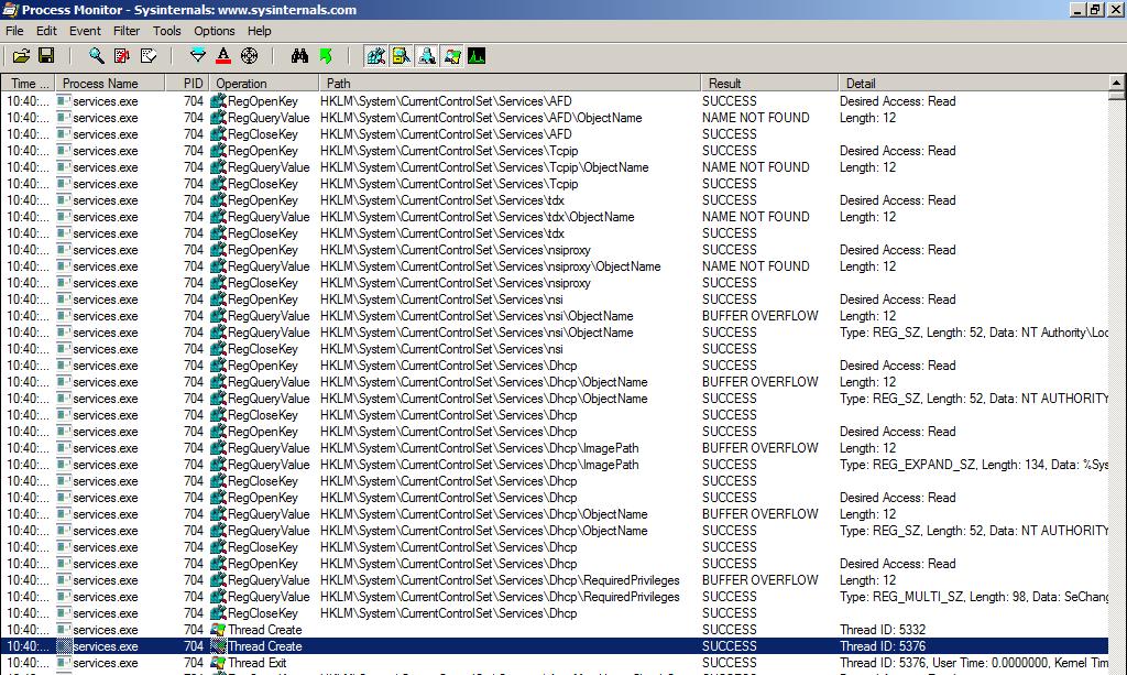

by: Simpson_STLPosted on 2009-01-18 at 23:55:46ID: 23408811
Dear RobWill,
   Thank you for your comment, Today morning I'm try to run as your advise,  and recheck permission in each refer registry It look ok but access deni still occure.
   Note: This log I'm capture during I'm try to start DHCP Client service until system show Error 5 Access deny, please see attach picture.
Please advise.
by: RobWillPosted on 2009-01-19 at 08:30:47ID: 23412015
No failures at all, that is odd.
Sorry, I have no other ideas. I am very interested in the solution and did a lot of research. Although the issue is quite common, the only 2 solutions seem to be the registry changes and reformatting the machine.
--Rob
by: McKnifePosted on 2009-01-19 at 09:54:47ID: 23412915
Simpson, your screenshot shows about 0,00000000001% of the whole log. You could save that log, rename it to log.txt and upload it here. Please add the exact times when the error is happening.
