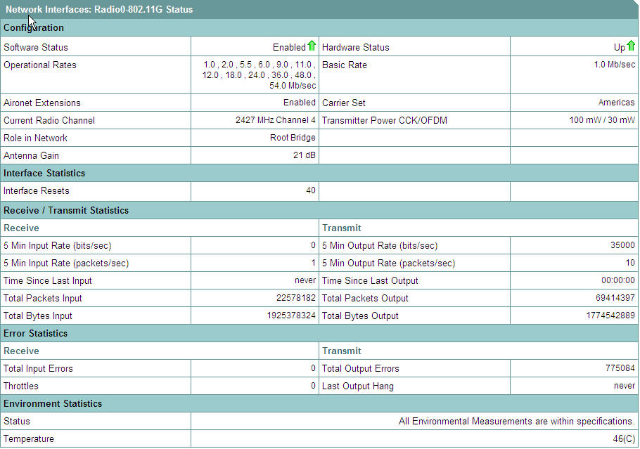

I have 2 Cisco Aironet 1300. 1st is setup for root-bridge and the 2nd is setup for non-root bridge. I use a test QCheck to test the throughtput and I'm only getting 3 mbps. Should I be getting more?? My setup on Cisco Aironet 1300 series is pretty basic or default.
Also, the external antena is perfectly align to the other building. Any ideas?
    • 140 KB
    snapshot of the radio transmission errors
2008-02-27 at 16:40:46ID23199070

You are getting a lot of output errors.  I would try the following things (in no specific order).

Actually, 775084 / 69414397 = 0.0111 or well under 2%. That's not an excessive amount of errors, in my opinion.

And it appears your power is turned up too high for the gain level you have.

What's the status screen (like you posted in your first message) look like now?
