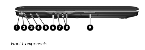

See the attached picture. It's a screen grab from the service manual available from http://h10032.www1.hp.com/ctg/Manual/c01311536.pdf - Callout # 4 is the external switch to toggle the wireless devices on/off. #5 is an indicator light for the wireless devices - blue means they're turned on, yellow means they're turned off.

I understand the operation of the wireless switch and the meaning of the colors. And no the switch will not change colors when toggled.
