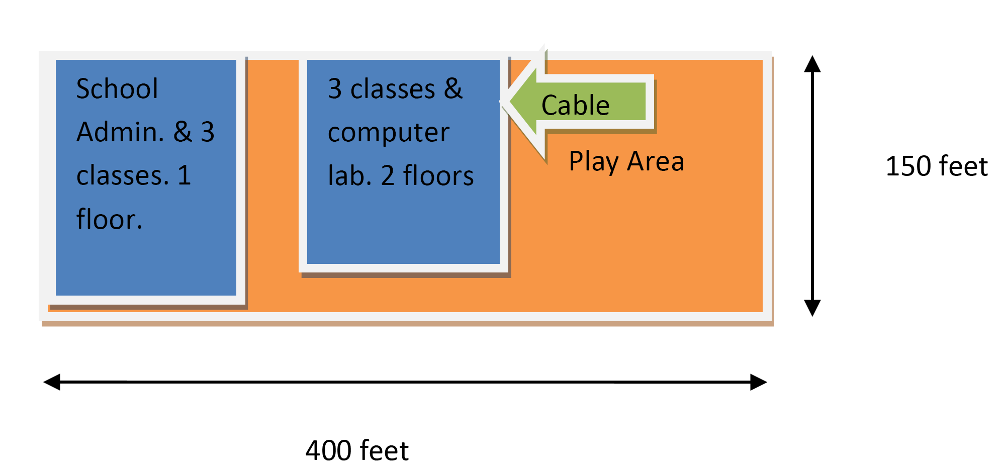

I am assisting a small elementary school in setting up a LAN for students and staff. The school has comcast cable at 12 Mbps. I would like to set the school up totally WIFI because it would give maximum flexibility and most of their PC's will be laptops. They need about 35 stations. The school  walls are built from solid concrete block which I understand attenuates WIFI signal. The roof however is a flat Bitumen construction. I've attached a plan of the school. They want to be able to use the LAN anywhere on the campus, including the school play area.
Can you advise me on a cost effective solution - thanks
Can you advise me the most cost efficient way to put this in place.

I would recommend purchasing Linksys WRT54GL routers (make sure they have the L so you can change the firmware to add more advanced features), I think I have seen these around for about $70.  Depending on how many walls there are you may be able to get away with 2 routers, one upstairs near the center of the area to be covered and one downstairs near the center of the area to be covered or you may need to use 2 on each floor if there are lots of walls or they are very thick.  The WRT54GL router you can upgrade to the freely available DD-WRT and use the routers together as one network, the reason you can accompish this with these routers is because they are linux based rather that the proprietary system used on the others.
If you decide to go this route I could probably provide you with more details.
by: tommca4781Posted on 2009-01-17 at 18:55:32ID: 23403477
Your cheapest route will be to go with some soho style access points(ie. linksys, dlink, etc). If there is  connectivity already in the "admin & 3 classes" building you are all set and can just stick an access point there, if not your cheapest route would be a wireless bridge/repeater.
You will need to loosely connect these access points to Ethernet cables and do a sitesurvey with your laptop to get a feel for how the signal is propagated in the building/rooms; you can use program netstumbler for this site survey.
You will want to configure the access points as nodes on the network in the same subnet with the same SSID. The access points should also be on non-overlapping channels (ie. 1,6,11) and the signals should only overlap 10-15% (you can tweek the range on the gui of the ap).
Sounds like a fun gig, have fun!
P.S. If you do not have a dns cache/filter so the kids do not go to bad sites you should check into www.opendns.com to distribute via dhcp. The free service works well for blocking and monitoring various categories of sites and is in use by many of schools. (again...its free)

by: brownoaks97Posted on 2009-01-17 at 22:46:30ID: 23404007
Folks,
First of all, thanks for such excellent responses. My special needs son just started in the school and I really appreciate your input.
The school have 4 routers at the moment albeit only 1 in use. They have two Linksys models WRT610N (B,G&N), plus an older linksys unit with 2 antennae (B&G) and a Belkin unit also with 2 antennae (B&G).
It seems to me that I could use these units perhaps supplimenting with additional unit(s) for the outside play area. I am not sure however how to connect the units to a single cable / modem. Is there an article you could reference that would help me with this?
Thanks all.

by: Darr247Posted on 2009-01-18 at 09:31:09ID: 23405602
brownoaks97,
If you could open the layout in Paint (Start->All Programs->Accessories) and indicate thereon the approximate current location of each router, we could give better advice on channel allocation and optimum locations for additional routers or access points.
