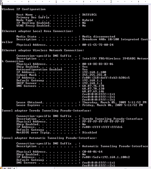

Open a command prompt and type IPCONFIG.  Look for then entry pretaining to your wireless connection.
It should show an ip address.  It the ip address starts out 169.x.x.x, then you are not acquiring an ip from the router.
If the wireless is in a disconnected state (no ip address), then the laptop failed to associate with the router and the Authentication, Encruption, and/or the key may be incorrect.

by: 5532Posted on 2009-03-05 at 17:49:16ID: 23813233
I took a screen shot of ipconfig (.gif) see attach. The dell laptop was connecting to Linksys. Why the difference with Netgear? The user interface to configure wireless security were sort of similiar.
I exchanged the Linksys wireless router with the netgear wireless. Using the netgear, I can't access the internet but the signal is showing on the taskbar. The Dell Laptop uses Intel® PRO/Wireless Network Connection.
Curious, does the ip address change on the wireless Intel adapter when wireless hardware swap out, ie Linksys to netgear. Please, any ideas? I just want to set this up for my sister. BTW, I am writing this via my Toshiba Laptop via Linksys wireless G router.
Anyways, I am at a lost. I don't see a difference.

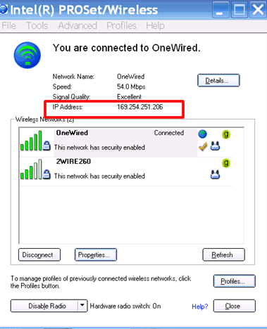

by: 5532Posted on 2009-03-05 at 21:09:06ID: 23814009
Okay. I thought I resolved the connection issue. Unfortunately, I disconnected the wireless router and re-connected. The connection is cycling and not able to hold. Now, I receive an IP address of 169.xx.xx.xx before it was 192.xx.xx.xx. I'm not sure how to resolve to the correct ip address which should be 192.xx.xx.xx. I look all over in the control panels. Someone please advise. Why did the ip address change? Thanks

by: QuetzalPosted on 2009-03-06 at 09:24:14ID: 23818842
The 169.x.x.x address is the APIPA address.  This is what the device gets asssigned if it is unable to obtain an ip address.
Verify that the Netgear has DHCP turned on.
by: 5532Posted on 2009-03-06 at 13:38:56ID: 23821310
I turned off the DHCP and I'm able to connect. Thanks Quetzal.
