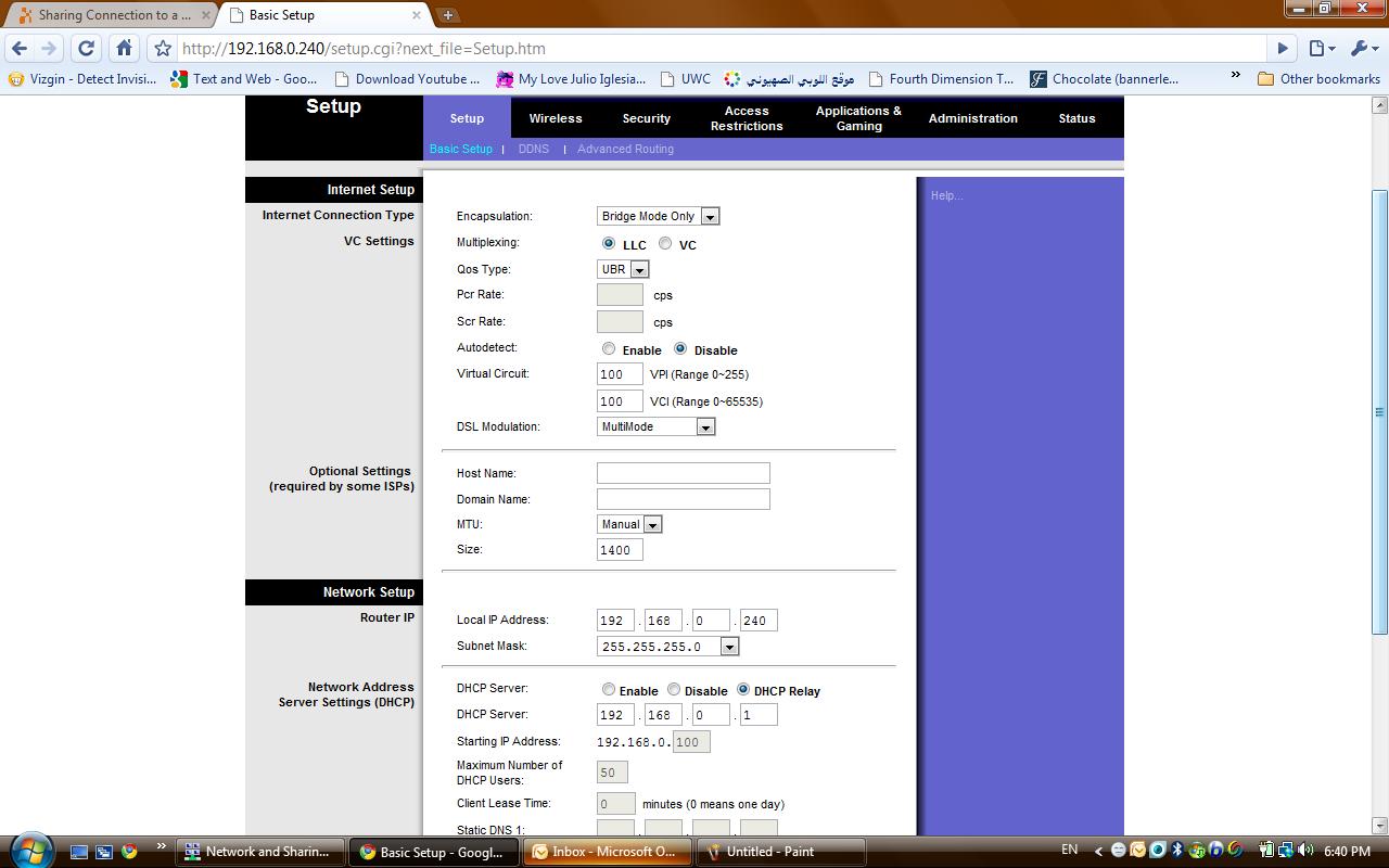

by: moh10lyPosted on 2009-05-30 at 08:43:16ID: 24509353
I DID IT ... DAMN it was soo easy.
I have made few amendments ... Connected a cable from the switch for my Linksys wireless router...
Changed Default router page from 192.168.1.1 to 192.168.0.240
Changed the Encapsulation mode from RFC 2516 PPPOE to Bridge Mode Only.
Changed DHCP Server from Enable to DHCP Relay...
Now Laptop connected automatically to the internet ...
Thanks so much for your help.
