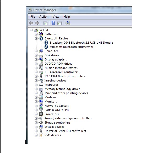

by: wmb02Posted on 2009-10-02 at 12:40:56ID: 25481307
My operating system is Windows Vista 64 bit.
In Device Manager there is a Bluetooth Radios entry (see attchment)
In "Add a Bluetooth Device" there are NO entries (see attachment)

by: MeretePosted on 2009-10-03 at 02:08:31ID: 25484498
Attached image from word but now in a snapshot
ref to wmb02 comments>
by: Darr247Posted on 2009-10-03 at 17:46:34ID: 25487701
Thanks.
In the screen that shows no bluetooth devices, is there an Add button?
I see you said you uninstalled and reinstalled the drivers, but have you updated its drivers to the latest version?
