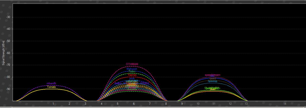

Take a look at the attached picture. It shows channels usage in my neighborhood.
I have tried channel 3, 8, and 13 and compared the result. I found channel 13 gives the best result in covering my house. Unfortunately, I cannot use it in just one of my laptop. I have 2 PCs and 2 laptops working with channel 13.

Yes, it is clear why - it only partly interferes with acess ponits on ch11. On other channels you have interference on both sides (nice pic, where did you get it from?)

PS: I used inSSIDer (http://www.metageek.net/products/inssider) to capture wireless signals in my neighborhood.

Regarding the attached picture the signal levels are not so high - below -70dB. I have tested signal strentgh thru concrete-steel wall and it was -50dB. That is 20 dB of difference and if I remember correcty every 3dB is doubling the strentgh.
