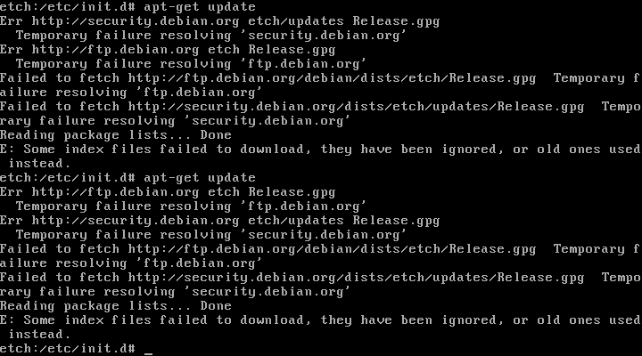

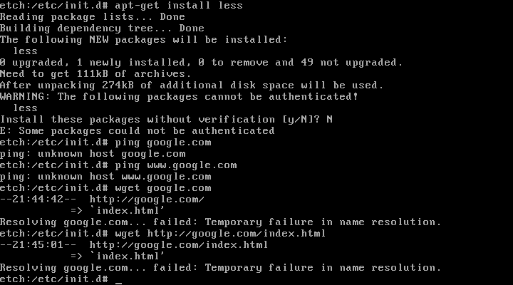

by: jazzIIIlovePosted on 2009-11-06 at 13:16:03ID: 25763125
It seems I haven't got either kdm or gdm because I couldn't run any of them when I tried for them.
I go to the directory of init.d, but It passes too quickly and I cannot see the g or k letter ones. Any interrupter command or an option for ls?:)
ls -l | something?
same for dpkg.
Anyway, when I say, apt-get install gdm, he says failed to fetch http://ftp.debian.org/debian/pool/main/ and_the_files_to_be_installed. I think the reason is as follows: (Please confirm)
I have an internet connection but the machine is a virtual machine in 7 and I can ping google.com from host machine, a 7 and cannot ping from guest machine, Debian...
in guest server, Debian
ping google.com
ping www.google.com
Best regards.
by: chenry334Posted on 2009-11-06 at 13:20:20ID: 25763162
There are a few commands you can pipe the output of ls to - more or less are the 2 most common.  ie: ls |less
It looks like your virtual machine isn't connected to the internet.  Can you post the results of 'ifconfig'?  Can you also post the contents of your /etc/resolv.conf file
Do you know if your Windows 7 virtual machine software is setup to do NAT or is it setup to bridge your VM to your actual network?  If it's running NAT does it provide DHCP to assign an address to your linux computer?

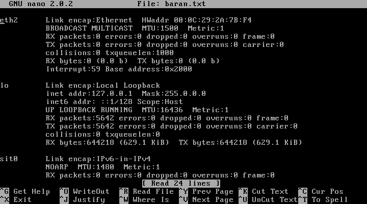

In Debian:
When I say ifconfig -a | less
less not found,
When I say ifconfig -a | more
It again pass it...
so, i redirect it to afile and get the shot...
Again same way, ls -l in /etc/init.d no gdm or kdm
Again same way, dpkg -l no gdm or kdm
Best regards.
by: chenry334Posted on 2009-11-06 at 13:44:42ID: 25763343
I've never used windows 7 virtualization so I'm not 100% sure how it works - I've always used VMWare.  But in order to install/fix anything in Linux it needs to be able to access the internet....
Typically vmware always runs a DHCP server for all of the VM's it hosts.  In linux you can try to obtain a dhcp address by running: "dhclient eth#" where # is the eth number of your nic.  Based on your ifconfig output it looks like eth2 - do you have more than 1 nic on that machine?  Was the Debian VM cloned or copied?  Linux assigns nic numbers in order - ie: eth0, eth1, etc.  I'm not sure why you would be using eth2 unless eth0 and eth1 were already assigned to active (or previously removed) nics.
If you want to set a static ip edit /etc/network/interfaces - the syntax to set eth2 to a 192.168.0.1/24 ip/subnet would be:

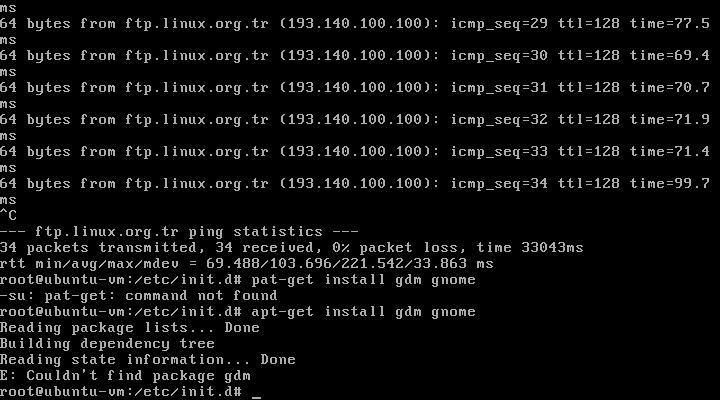

by: jazzIIIlovePosted on 2009-11-06 at 13:49:08ID: 25763377
Ubuntu 9 server edition

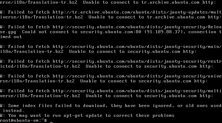

I tried apt-get update
He tries to connect tr.archive.ubuntu.com (193.140.100.100)
but he got stuck...
same for apt-get install gdm gnome as attached...

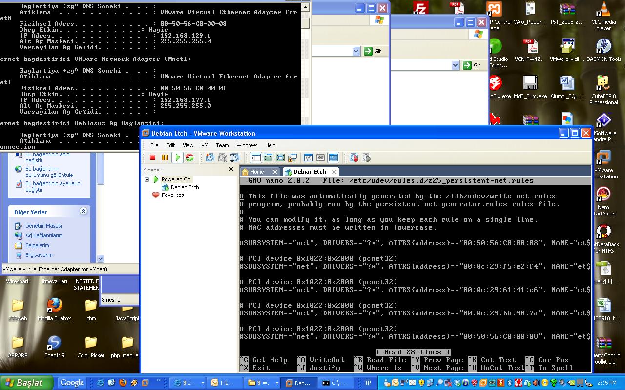

Nope one network interface
Copied. This could be the issue?
>>Linux assigns nic numbers in order - ie: eth0, eth1, etc.  I'm not sure why you would be using eth2 >>unless eth0 and eth1 were already assigned to active (or previously removed) nics.
I have no idea too..:)

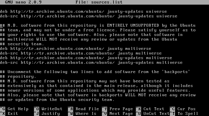

Can you post your /etc/apt/sources.list file?  You should be able to run apt-get install gdm gnome or apt-get install ubuntu-desktop unless your apt sources list is wrong

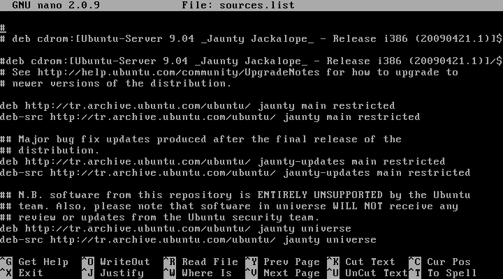

by: jazzIIIlovePosted on 2009-11-06 at 14:30:36ID: 25763646
ok...I attached 2 files, since it must be scrolled:)

by: chenry334Posted on 2009-11-06 at 14:50:37ID: 25763774
Did you run 'apt-get update' on your ubuntu box?  Your sources.list file looks right - the GDM package is in the jaunty main branch.
The 2 entries:
deb http://tr.archive.ubuntu.com/ubuntu/ jaunty main restricted
deb-src http://tr.archive.ubuntu.com/ ubuntu/ jaunty main restricted
should provide the packages...
by: jazzIIIlovePosted on 2009-11-06 at 15:33:52ID: 25764020
when I run for it, he tries to connect for 3 or so minutes and gives the result in following screenshot.
by: chenry334Posted on 2009-11-06 at 15:45:53ID: 25764090
Is your ubuntu machine connected to the internet?  Can you resolve DNS properly?

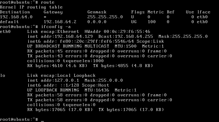

by: jazzIIIlovePosted on 2009-11-06 at 15:54:01ID: 25764127
yes I can ping google com
The others are as follows, they seem working...Note that I am not in starbucks and plug LAN and apt-get install gdm still now working...

apt-get install gdm
blabla
Package gdm is not available, but is referred to by another package.
E: Package gdm has no installation candidate...

by: jazzIIIlovePosted on 2009-11-06 at 19:15:14ID: 25764823
route returns:
Kernel IP routing table
Destination Gateway Genmask Flags Metric Ref Use Iface
192.168.64.0 * 255.255.255.0 U 0 0 0 eth0
default 192.168.64.2      0.0.0.0 UG 100 0 0 eth0

ok, I have made it worked in virtualbox, ubuntu and XP
Ubuntu and XP are working in Vmware 7.0 too.
The Debian I have some issue right now, as in the original question.
when I say apt-get update in debian, no joy:
as in the shot.
by: jazzIIIlovePosted on 2009-11-06 at 23:43:42ID: 25765357
by: jazzIIIlovePosted on 2009-11-06 at 23:46:40ID: 25765367
He gives the similar error for ftp.debian.org/debian/pool...
He cannot figure out ftp.debian.org.
How to fix it? After all, we turn back to original question in 10 hours:)
by: jazzIIIlovePosted on 2009-11-06 at 23:58:23ID: 25765389
in fact, he connects as you see when I say apt-get install less
But somehow, he cannot connect and install the package
When I say wget google stuff, examine the last screenshot...
He can resolve google.com...
What to do?

by: jazzIIIlovePosted on 2009-11-07 at 00:26:11ID: 25765436
ping debian.org
ping: unknown host debian.org
ping www.google.com
Same above
ping 72.125.53.100 (I nslookup in windows for google.com)
connect: Network is unreachable
It's NAT. My scratch VMs can connect. Why not this?
As in above, he seems very close to get the packages.

by: jazzIIIlovePosted on 2009-11-07 at 01:22:12ID: 25765559
Ok, ifconfig -a result as follows:

by: jazzIIIlovePosted on 2009-11-07 at 02:15:45ID: 25765694
I even edit:
nano /etc/apt/sources.list
changing the repository from http://ftp.. to ftp://... or adding country extension ftp.tr blabla...
no joy.

by: jazzIIIlovePosted on 2009-11-07 at 04:22:31ID: 25766004
The very last shots: I think ethernet is not recognized in the VM.
To prove my state, I take the same VM in Windows XP in VMWare 6.5, so no compatibility issues.
When he is booting, he says he couldn't find the interface and when I ifconfig -a, I got eth3 as in shots
In the file as in scr, the MAC is the original MAC of my friend's machine, so, I think I need to edit this
/etc/udev/rules.d/z25_persistent-net.rules file as in the shot, but how?, I tried but failed. The contents are as follows. I changed the MAC given to my VMWare 8 adapter since I am NATTING. This is my borderline. I have no other ideas. Please help me.
Best regards.
P.S.: I editted the DNS as 192.168.2.1 my gateway IP aka DNS server IP as cmd->ipconfig /all tells so in XP.
by: jazzIIIlovePosted on 2009-11-07 at 05:54:19ID: 25766324
Unbelievably, I finally reach the server...
I edit /etc/udev/rules.d/z25-persistent-net rules:
with this:
blabla...ATTR{address}=="mymacinsmallletters", ATTR{type}=="1", NAME="eth0"
voila, I can now reach it and downloaded gdm, started gdm, he says where is xorg-server, after the apt-get, I was waiting finally for the desktop, but noo...my karma is low, there appears a wizard for xorg. I mean, I make the stuff default, only for the card is as default vesa, I changed it to wmware and no gui again...
When I go /etc/X11/ xorg.conf is empty 0 byte. Why does Debian torture me?:) Anyway, I am on it...
Best regards...
