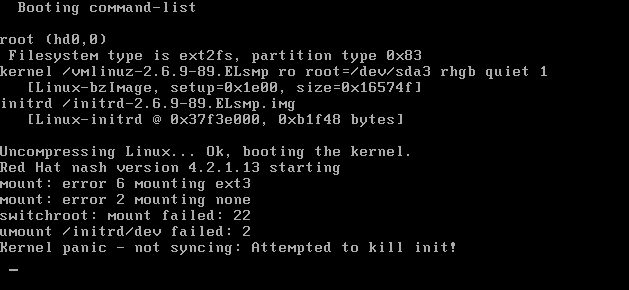

by: david-martiPosted on 2009-08-04 at 02:20:52ID: 25011729
Attached is a screenshot without "quiet" parameter on kernel boot. Perhaps it helps a little more to see what is causing this boot error.
Thanks.

I read now your second screenshot; which is you root filesystem? Grub is configured to use /dev/sda3, is it correct?
by: david-martiPosted on 2009-08-04 at 02:31:17ID: 25011791

by: david-martiPosted on 2009-08-04 at 02:35:00ID: 25011803
Yes, /dev/sda3 is the partition with the root filesystem.

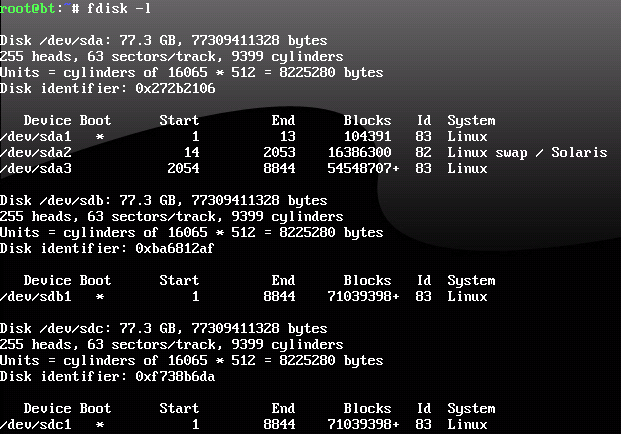

by: david-martiPosted on 2009-08-04 at 02:44:51ID: 25011845
This screenshot is fdisk -l. You can see /dev/sda with 3 partitions:
sda1 is /boot
sda2 is swap
sda3 is /

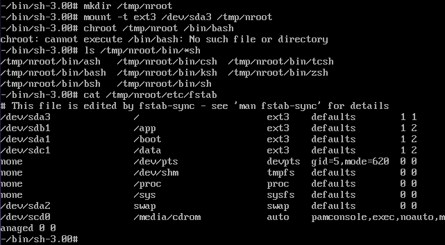

by: david-martiPosted on 2009-08-04 at 03:09:52ID: 25011963
same error when trying chroot with bash. This is the screenshot with this error, plus ls /tmp/nroot/bin/*sh and a cat from fstab file.

I have a doubt: If initrd was corrupted ... kernel modules (second screenshot on this thread) will be loaded? If you see the second screenshot, you'll see several kernel modules load, and, I think it's only possible if the initrd is successfully loaded into memory.
by: dainokPosted on 2009-08-04 at 04:32:41ID: 25012427
I can't understand why /tmp/nroot/bin/bash exists but chroot cannot find it, try to execute it:
mount /dev/sda3 /tmp/nroot
ls /tmp/nroot/bin/bash
/tmp/nroot/bin/bash
chroot /tmp/nroot /bin/bash
The fstab file seems correct, but maybe it contains dirty character (boot messages report about "ext3" and "none" filesystem, maybe an EOL is missing). Backup it and create a new fstab with only needed entry, then reboot:
/dev/sda3 / ext3 defaults 1 1
/dev/sda2 swap swap defaults 0 0
none /proc proc defaults 0 0

I successful replicate you chroot problem: chroot: cannot execute /bin/sh: No such file or directory
Probably few libraries bash need are missing in chroot filestytem.
Check if this files are present:
(i386)
# ldd /bin/bash
        libtermcap.so.2 => /lib/libtermcap.so.2 (0x00378000)
        libdl.so.2 => /lib/libdl.so.2 (0x0091e000)
        libc.so.6 => /lib/libc.so.6 (0x00947000)
        /lib/ld-linux.so.2 (0x00901000)

by: david-martiPosted on 2009-08-26 at 01:39:22ID: 25185403
Great! If I boot my system with linux rescue DVD, the /mnt/sysimage/lib is missing!! (You can see an screenshot on this thread, Imagen-4.png)
I don't see this "little" detail before.
If /lib directory was removed, this can cause the boot problem? I think the answer is yes!
