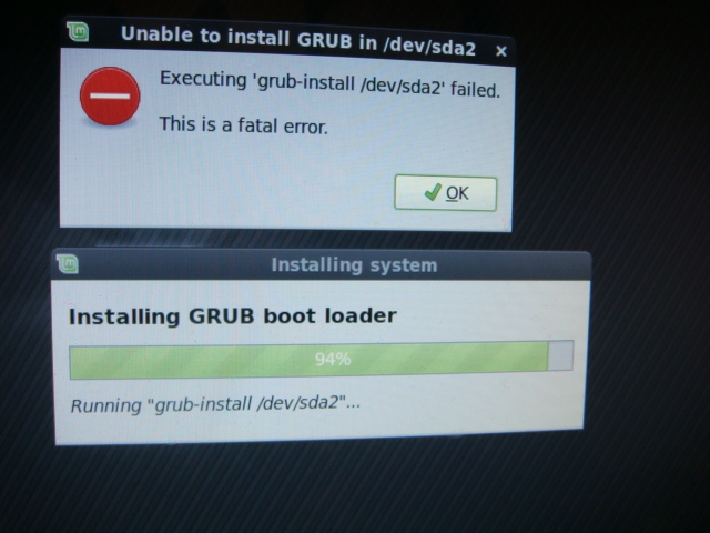

I used gparted and created a separate ext3 partition.  During install of Linux Mint i selected that partition to install /.
For bootloader i set it to hd(0,0).
the install then fails with an error message about the bootloader.
i also tried the linux mint "side by side" installation and that didn't work either (same error).

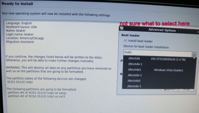

"(The trick is to not install the Mint bootloader to the MBR of 'hd0,0', but to the Mint root partition, then configure EasyBCD to run it)"
This is exactly where i have no clue what to do.  I've attached a few screenshots of the Linux Mint 7 Install (from bootable cd-rom).  I'm currently at the "Advanced Options" part of the install (third attachment).  I would really appreciate some direction here.

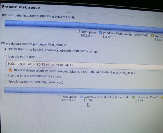

by: braker15Posted on 2009-06-04 at 12:19:46ID: 24550443
in the last post I had selected "Specify Partitions Manually".  I then selected the 70GB EXT3 partition and formatted it and set the path to /.
"What do you mean by installing Mint "alongside"? Does this mean installing the Mint bootloader into the Mint partition?"
The prepare disks space jpg has a radio option for installing Mint "side-by-side" with windows.  That is what i was referring to.
by: torimarPosted on 2009-06-04 at 12:32:59ID: 24550589
If you wish to use EasyBCD as the bootloader for both, you need to click the arrow in the "advanced options" dropdown, then select the "sda2" partition as location to hold the bootloader.
After the installation, boot Win7 and follow the instructions in the link I posted above.

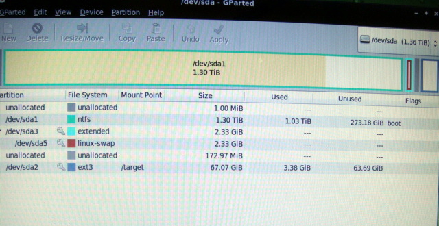

by: torimarPosted on 2009-06-04 at 12:35:36ID: 24550613
I discovered something odd about your partition setup.
Should you encounter a bootloader problem again, please boot into the Mint Live system (from the install CD), and check the system/administration tools for "GParted" or "Partition Manager".
Run it, and make a screenshot of what it displays about your hard drive setup and post it here.

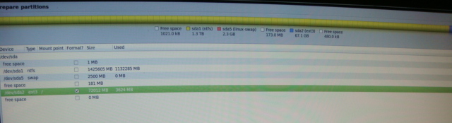

by: braker15Posted on 2009-06-04 at 12:55:30ID: 24550786
i hit an error during the install (see screenshot).  I also attached the requested gparted screenshot.

by: torimarPosted on 2009-06-04 at 13:20:21ID: 24551028
Yep, it's as I thought: you have an extended partition (sda3) with a logical drive (sda5) *in the middle* of two primary partitions (sda1 and sda2).
In 15 years of multibooting I never had a setup like this, and I should even have thought it's impossible to create. This could very well be the cause of this "fatal error".
Please do this:
- Rerun GParted (I'd suggest to use a separate version of GParted, not the one included into the installer; partitioning is a delicate matter - it's wise to apply changes pretty often in between a longer procedure. If you don't have the Mint Live CD, use Parted Magic, it's only 80 Mb: http://iso.linuxquestions.org/download/737/2150/http/downloads.sourceforge.net/pmagic-4.1.iso.zip)
- delete all partitions underneath the Windows one; use this sequence:
---- Swap
---- Extended
---- Unallocated
---- sda2 (ext3)
- apply changes
- create a new extended partition encompassing all the unallocated space at the end of the disk
- apply changes
- inside the extended, create a logical partition for Mint (all space minus 3 GB, formatted ext3)
- create a logical partition for Swap at the end of the drive (3 GB, formatted swap)
- apply changes
Then reboot from the install CD, select sda5 as mountpoint for "/", sda6 as mountpoint for Swap, and install the bootloader to sda5.
If it works, congratulations.
If not, we'll have to dig into the fact that this is a pretty huge disk, and what this could possibly mean for Grub and booting Linux on a sector that is 1300 GB deep down inside the drive. Personally, the highest sectors I ever booted Linux from were around 600 GB.

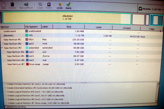

by: braker15Posted on 2009-06-04 at 17:59:22ID: 24552778
I used gparted live and made some changes.... i attached a screenshot.  Does this setup make sense?  do you think it will work?
Thanks!
by: braker15Posted on 2009-06-04 at 18:22:38ID: 24552854
well that didn't work, failed again while executing grub install sda3 (where i had /)
