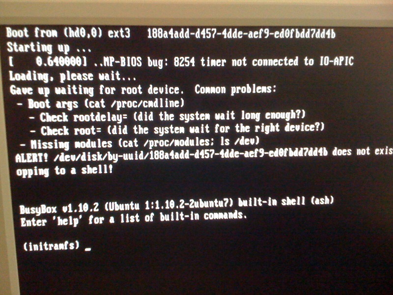

I am exploring Ubuntu Server.  I installed it on an older PowerEdge 2550 yesterday.  When I boot up, I get the screen you see in the attached image.  If I type "exit" at that prompt, the OS (not the machine) seems to restart itself and it is then working just fine.  What's going on?  Should I take some action here?

    This is what I see after the system starts to boot up.

by: thehagmanPosted on 2009-08-27 at 13:01:43ID: 25202084
Seems related to this:
https://bugs.launchpad.net/ubuntu/+source/linux/+bug/290153
You may want to add a line
rootdelay=90
to
/boot/grub/menu.lst
by: mrcoulsonPosted on 2009-08-27 at 13:19:45ID: 25202250
I will try that and reboot the machine ASAP!
Jeremy
by: mrcoulsonPosted on 2009-08-28 at 04:28:00ID: 25206442
Lord!  Now the thing starts up perfectly and I haven't had a chance to try this out.  Mind if I leave this open for a few more days to see if the problem reoccurs?  It was happening on EVERY reboot.
Jeremy
by: thehagmanPosted on 2009-09-05 at 09:30:18ID: 25266800
If the problem is transient, it could of course be a real hardware problem with the disk, i.e. it starts too slow - sometimes. After all, you said it was an older box
by: mrcoulsonPosted on 2009-09-08 at 05:31:32ID: 25281134
Yeah, it's happened again since.  I hope to actually have time to try your idea today.  I think I moved the server out of my office prematurely because I don't get over there to the server room too often.
Jeremy
by: mrcoulsonPosted on 2009-09-09 at 07:07:03ID: 25291420
Okay, that idea didn't work.  I tried it twice.  I suppose I could enter a much longer wait time, but I don't think that should be necessary.  On another test install at home, I didn't have this issue.  It's probably just that it's an old machine with hardware problems.  This is the third time I've installed Ubuntu Server on this machine, so it can't be a bad installation.
Jeremy
by: mrcoulsonPosted on 2009-09-09 at 07:07:23ID: 31621376
Must be a hardware problem!
