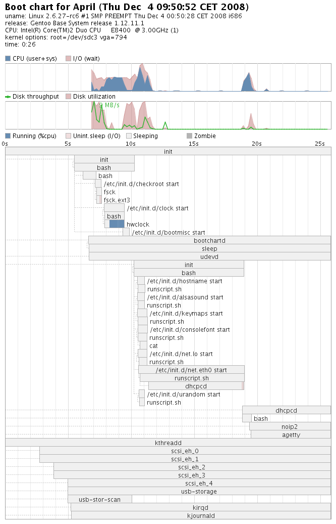

Ok, I could patch the kernel fine, and compile the programs. I made a list for sread on what files to preload, and I think I got that part working, because my latest bootchart show a great deal better disk usage, but also a lot more disc usage, so made I'm loading to much data...
Anyway, I didn't gain a single second (from 27 secs) on my boot time, which feels wierd. Logging in to KDE feels somewhat faster, but I haven't measured the time yet.
I'm attaching a bootchart. It's a bit old, but still more or less accurate. I'm wondering if at least part of my problem is that I don't start a lot of "large" programs, but instead dhcpcd is taking a significant amount of time, which sread can't do much about.
by: letharionPosted on 2009-01-08 at 03:49:59ID: 23324017
Here's the latest bootchart :)
