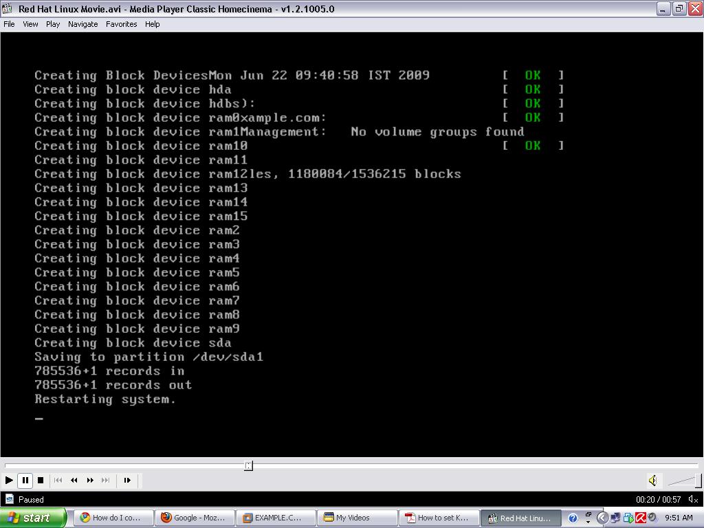

sorry to interrupt here after seeing this question i also tested/tried this url
http://kbase.redhat.com/faq/docs/DOC-6039
after running echo command system rebooted immediately  pls see the attached pix  doest this gives u same output?
i made an partition /dev/sda1
nd in /etc/kdump.conf
raw /dev/sda1
after restarting the system is up nd running .... iam not sure but i think it has worked??
by: ravenplPosted on 2009-06-21 at 23:36:24ID: 24680089
It looks like it saved the kdump.
