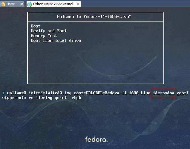

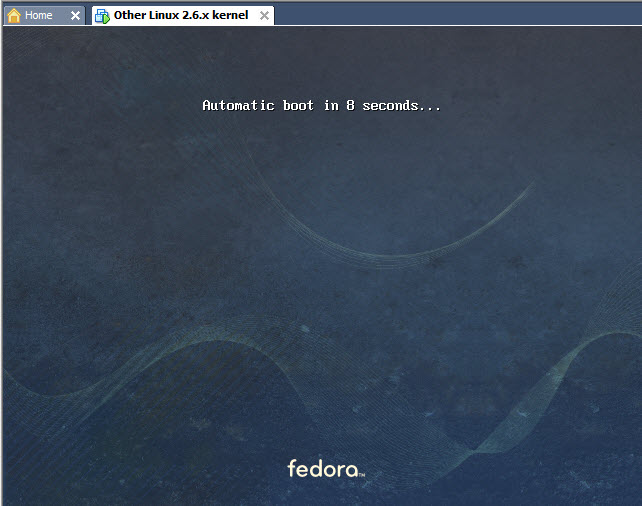

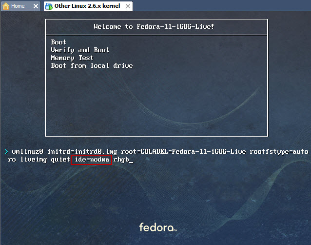

by: grind67Posted on 2009-09-24 at 05:43:16ID: 25412651
thx,
I tried couple of boot options but still no luck...it goes to black screen and nothing after. It just stays there
Please check the attached screenshots
by: allen-davisPosted on 2009-09-24 at 11:43:23ID: 25416408
If you are not seeing the 'squash' error now, try a generic video driver like xdriver=vesa as a boot option the same way you tried ide=nodma.
by: grind67Posted on 2009-09-25 at 01:59:35ID: 25421161
Hi Allen,
No luck...still I get the same blank screen after giving those 2 options

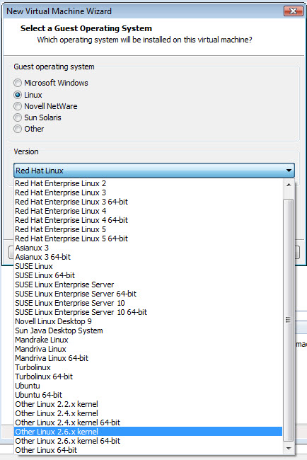

Glad you're able to get Fedora running.  Maybe take a look at how the two machines are defined to see if you can find some difference. When you created the virtual machine definition, did you specify that it would be a linux machine?  If you still want to install Fedora for yourself, don't give up. If nothing else, new versions come out about twice a year I think.
by: grind67Posted on 2009-09-25 at 19:58:14ID: 25428595
thx...will re-try later :)
Yes, I selected select Linux please check the attaced image.
